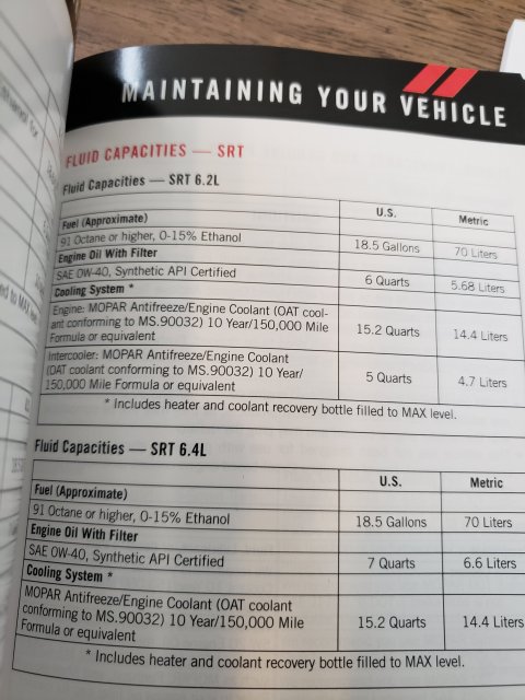

The dipsticks in the 1st 2 years is different then the later cars. They made them shorter in 17 or 18 to read more oil and must have changed the owners manual to 7 quarts
Here is a pic of my 2016 owners manual
The factory service manual I purchased in 2020 for my 2016 says 6 as well. Wonder why they wouldn’t have updated that, it’s all electronic.
So according to the manual attachment the 6.2 holds 6 Quarts with Filter and the 6.4 hold 7 quarts with Filter. If FCA used the same dipstick for both motors the 6.2 and the 6.4 would that not confuse many on how much oil was actually full on the dip stick? So maybe that is why they changed the dipstick? Just saying. I have bitched about Ram dip sticks for last two trucks I owned and one RT 5.7 Charger. I put 7 Quarts in the Ram and scratched it with an awe on the dip stick so I would know where full was. Same on the 5.7 RT and the same on a 6.4 Scat pack as well. That ended tring to figure out FCA screwed up Dip Sticks! One 2014 Ram I owned 5.7 Actually held 7 1/2 to the full mark!

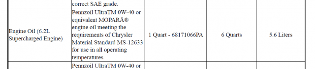

FSM states 6 quarts for 2015-16 cars.

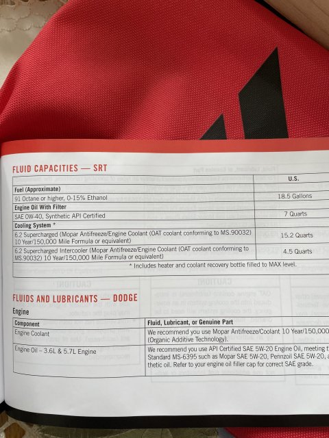

D034E980-9C6B-445C-A6CA-C6559416079A.jpeg 2019 shows 7 qts. Funny how the 6.2 is listed as SRT without the engine size. The previous page has the 6.4 listed as 7 qts also.
#58
I put 7 in both the 6.2 and 6.4.
