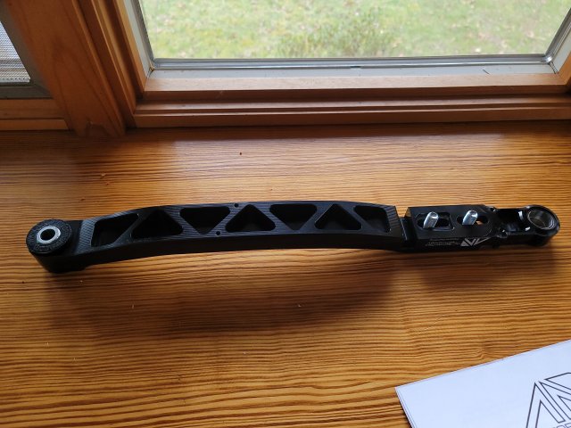

Got some aad parts this week. Definitely beautiful when you see them in person.

I had the trailing arms last year and just picked up the control arms. I will have to plan changing the gears, control arms and cradle bushings all at once
I got the drag pack and the toe arms. And the per4mance diff brace. No bushings for now. Figured if I swap springs later I'll do them at that time 🤷‍♂️

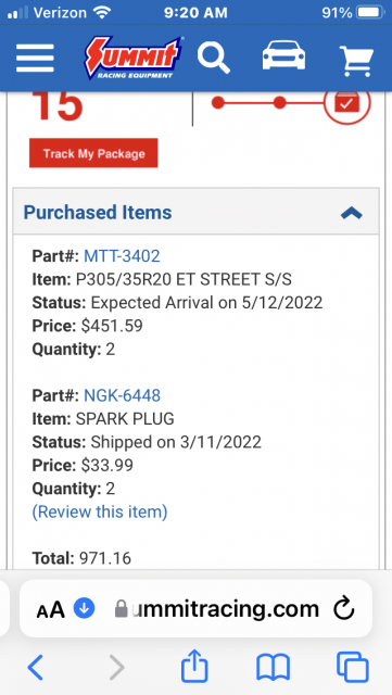

305/35-20 ET Street SS, my mistake, pushed out to 5/12 , but still, Every time it would gets closer gets pushed out another month I can’t wait that long any more. DD290E65-0DA8-4F47-A8BB-12895F3A4803.png

305/35-20 ET Street SS, my mistake, pushed out to 5/12 , but still, Every time it would gets closer gets pushed out another month I can’t wait that long any more. View attachment 67470

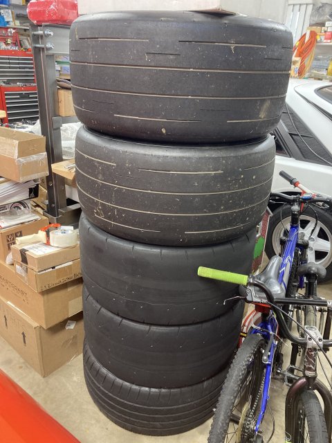

Have them, 315/50-17 MT Street R, on the street with no burnout that hook worse then a Nitto 315/35-20 555R2. I’ve done a same day same place within 1/2 hour 1/4 runs of the 315 NT05R, 315 555R2, and the MT 325/50-17, the 555R2’s gave me the best street 1/4’s. Here they are in my garage, I use them at the track only
