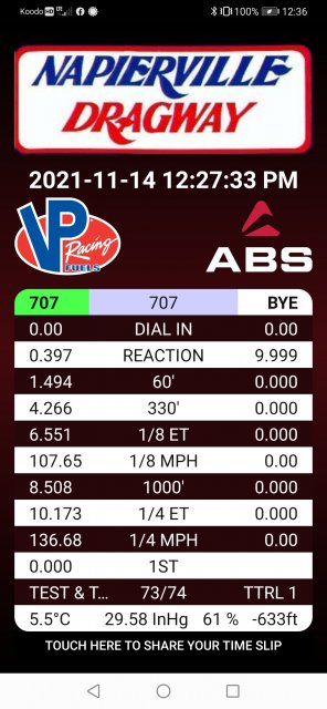

Still no timing added. Screenshot_20211114_123645_com.dynogeek.racingslips.jpg

Looking like you should have wrote a tune with a few more degrees just for fun 😊 I bet you’d been tempted using it after that pass
I used 1 with 1 degree added and I didn't like it so I went back to stock timing.
James will look at the log and tell me if I over reacted.
Still happy with the run and to be out this late in the year.

Looking like you should have wrote a tune with a few more degrees just for fun I bet you’d been tempted using it after that pass
His car is running pretty much right on th edge for the current fuel in the tank according to his logs .
It’s why I gave up on my 93 tune for racing. Fuel quality gets much worst when we have good air.
Trans and some other settings will be a big a big gain. As you have shown
