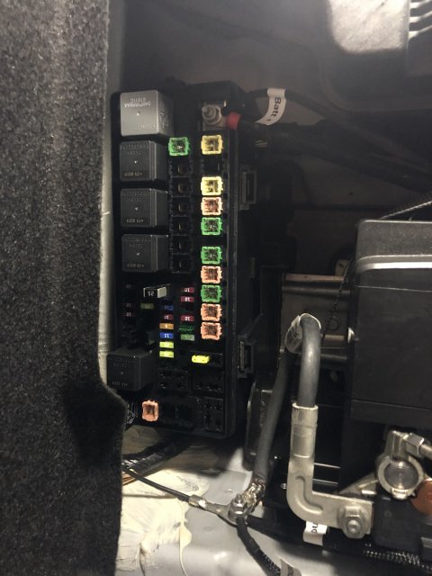

power on corner post of fuse panel
2 grounds on factory post beside fuse panel

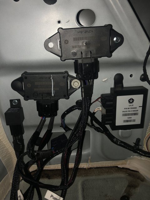

Fist and Second fpdm and y harness only go together one way I’m pretty sure

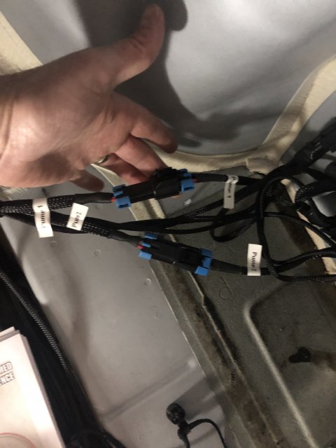

pump 1 and 2 wires clearly labeled all the way to the hat.

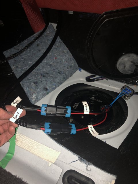

wiring connector on the hat

Checked the wiring again. Seems to be correct. Excuse the mess, I didn’t secure it all down yet because I wanted to make sure it was working first. The primary fpdm is the one with white line on it.
