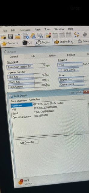

Nothings cool till it’s running but thanks. i been so stressed out back and fourth tow here tow there it starts to fry your brain a bit. I just was quoted today 1300$ just to paint my front bumper and yes it’s brand new so minimal prep would need to be done that doesn’t even sound right ! 😂 🤦 seems as though I’m going to have to store the car until I see hopefully one day on eBay someone selling a full set of “2022 charger redeye jailbreak computers W/keys” and I probably have a better chance of hitting the lottery. it’s pretty crazy how the dealership won’t work on the car, and just make there money I have proof of sale and they can easily run my vin to see the motors not stolen I just don’t understand them but they sold me a un programmed RF hub 🤦

and sometimes it is just that easy on most copart swaps but that’s if your lucky, most people when they start these they always somehow end up way over there projected budget unless the car you buy as donor is fully functional when everything is pulled from it but then still everything needs to match computer wise if your missing 1 thing it can cause a bunch of warning lights on dash especially when swapping into a 300srt8 appose to another charger to charger swap as most of the year differences in plugs and also due to it being a redeye they don’t come with fog lights and the headlights need to be wired also along with fog lights directly to the car so yea parts of the job can be super technical and another unexpected part was when we droped front and rear cradle to my 2012 to put the 2022 cradles in from redeye all 8 cradle bolts all snapped dead in half for some reason it’s the only thing/bolts that seem to have grew really bad rust so took a extra 2-3 hrs just to fix the snapped cradle bolts and replace with bigger/stronger bolts went with almost 2x as thick for anti rust purposes and strength especially when accommodating a car with 900hp my tune on high octane is 1022Hp my redeye drivetrain has a upper pulley upgrade has injectors ported blower oil catch can and can run E85 if wanted

Download Alfa obd, might be able to program the rfc control module. If not, you’ll need to get in touch with a shop that has a witech. They can do it for you
