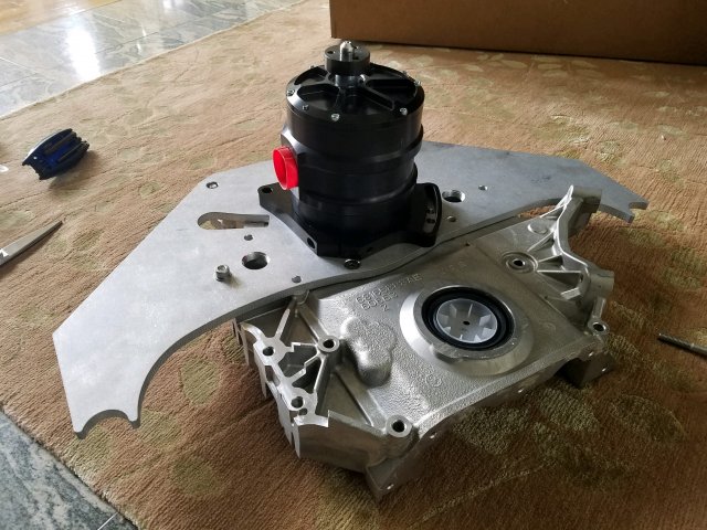

It is X Mas in May, front motor plate is done, the black thing in the middle is a big ass vacuum pump that is designed for pro mods.

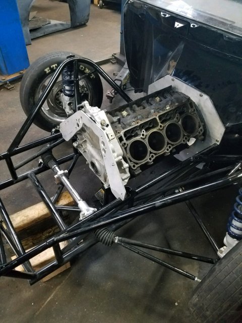

Jackson's Point
The motor is now part of the chassis now with the 2 plates .
