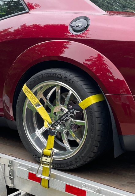

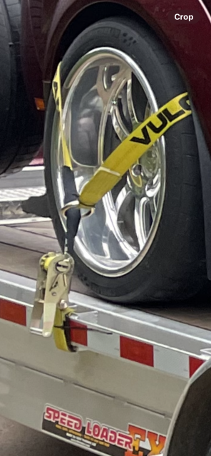

Agree. Except that I'd use the far more substantial stake pockets instead of the rub rail.
6,822
43,269
#74
Why? The car is positioned for the center of its mass to be where I want it. Jimmy for the experience you have, I am surprised you are telling me to position the car with respect to some minor shit on the trailer as opposed to getting it in the correct load point on that trailer. Show me structural calculations where tying it where it is positioned is not adequate on that rail. Show your work and I will be interested in vertical vectors please.
6,822
43,269
#75
You may also want to research the distance btw our axles and the position of those “stake pockets”. Before you get to carried away, sir.
5,531
10,603
#76
In your case, if the car is positioned correctly for tongue weight, I'd run the lasso strap to a stake pocket D-ring in the stake pocket just behind the center of the tire.
I have never run four lasso straps straight down vertically, wanting more fore and aft efficiency. And why the stake pocket D-rings? Because I only use hooks with clips, not wanting anything to possibly be able to detach.

When towing my cars with expensive suspension, we always have rings on the body, and keep my shocks from beating themselves to death. Hundreds of miles of towing = 4X the dragstrip passes on the suspension. Just how we do it with our racecars. Opinions and applications vary....

Thread Starter #80
Thanks. I did a bunch or research and this was a popular setup, but my immediate reaction is the pulling down and to the side does almost nothing for F-R support. In hard braking I would expect the car to shift forward until the strap is at sufficient angle to provide rearward support. I was thinking maybe using this system and adding another strap from the D ring to the trailer rear tie down point.
