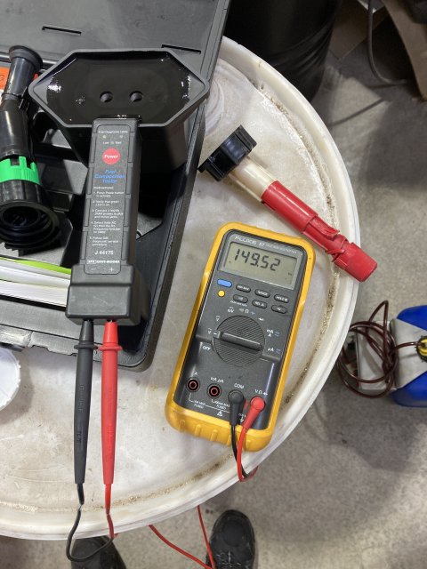

I picked up a 55 gallon drum of this today to get back up to 85%E :)
We’ll see how the car calculates it and if knock goes away or not. If Knock stays unchanged with higher octane fuel pretty safe to say it’s false knock?
Tester says it’s 99.5% alcohol
