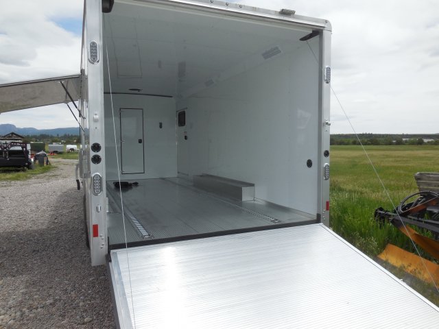

A 20-footer is enough, if using wheel nets and idlers so the tie down ratchets only have to come past the car by a foot or so. Of course, that requires E or L track spaced correctly for the track width.

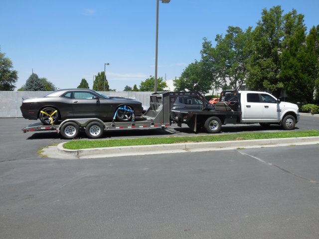

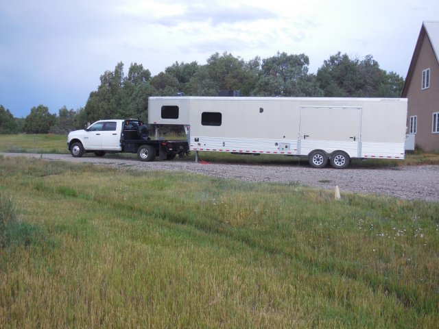

Well, I must admit that I never took stopping distance into account when deciding on trailer size.
Luckily I have a 30-foot trailer, too. And if that's not enough, I could put a mattress and/or a tire wall at the front of a 35-footer I have.

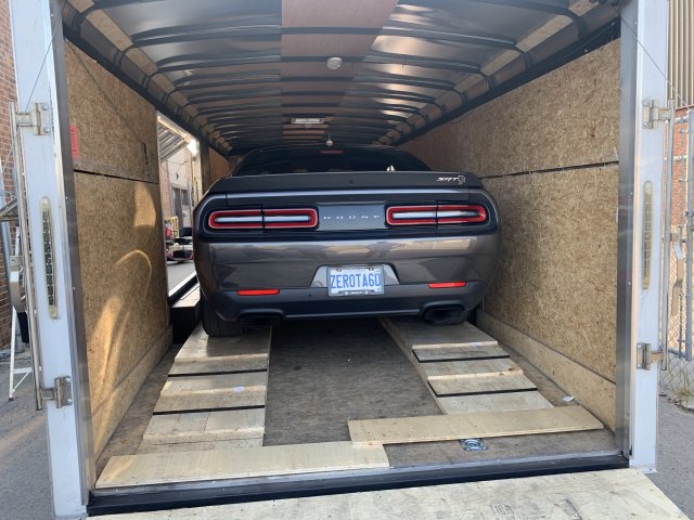

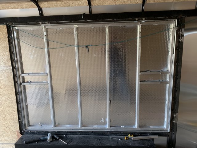

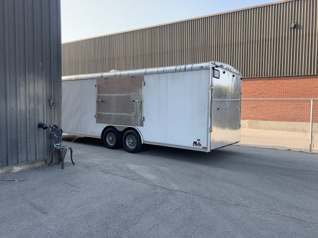

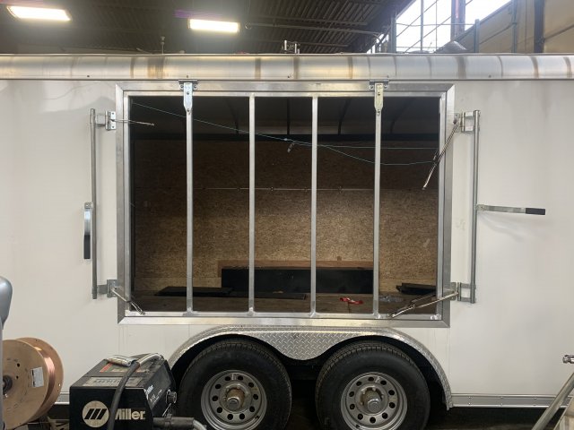

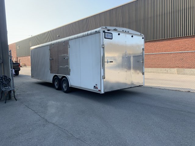

Is that a 26’? Look forward to seeing it finished.
24 foot....I think.:unsure: It is almost done. I will be checker playing the whole interior. I will post my build thread when I’m done.
04A518AF-9E2A-4B81-A2BD-49C9CBCCF73C.jpeg 4E14DF1E-844E-4EAE-B01D-CA877CA02019.jpeg 6D70B26E-76BF-44BD-BC64-46750760221A.jpeg 690436E1-42C8-4DD0-B0E5-7048182C57BA.jpeg 5F4B6E57-877B-4901-8B34-75A862CEFE6B.jpeg

I was wondering about door clearance...until I saw the last photo. Elegant solution.

I will be wrapping the whole floor in chrome checker plate so the wood I screwed down will be hidden. I am also going to do the walls in chrome checker plate. I have all the material in stock. I just have to find some time after work to finish up the trailer. Also by raising the car it makes it easier to strap it down.

Just don't make it too slippery. Wood is pretty good at providing traction (when dry).
What are you doing for tie downs?

I was also thinking about the traction. If the checker plate is too slippery then I will just put some industrial grip tape just where the tires roll. I am not sure yet. I have never modified a trailer before so I am learning as I go.
I just use regular all purpose heavy duty tie downs nothing fancy.
