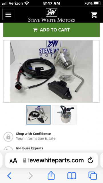

A true plug and play Fore system from Tapped Performance, Which unfortunately all of the four systems no matter who you buy them from is going to have the quarter tank bullshit of if you run below that we’re going to suck air because the fuel pump just hang there in the tank. Or you could look into a fuel system from Steve White Motors that uses the stock fuel tub and hangs two pumps in it which supposedly you could run the tank until almost dry and not have that fuel starvation issue. I have one but I haven’t tried it yet but I need to because my dual 285 pump system is a bit on the small side now since I’ve made a boost and injector upgrade. I’m thinking of selling my dual 285 Fore system it if you’re interested in it let me know.
Link to Steve White pump system below
https://www.stevewhiteparts.com/p-1...al-high-performance-fuel-pump-e85-gas-swmhcdu
