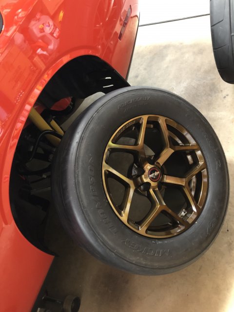

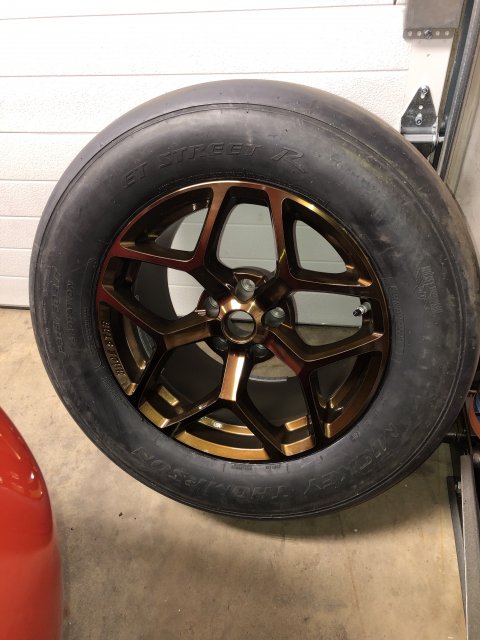

Going to try these 315/50-17 on 10 1/2” Race Star Recluse this spring with a 2.98 first gear M6, hoping for a 1.6 or better 60’. If it works then get a set of skinny’s for the front.

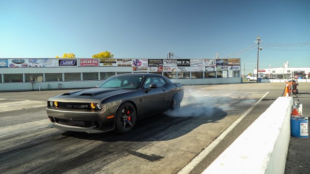

17" Racestars with 305ETRs can't go wrong with that setup. That is hpindy on the left. Yes he beat me.

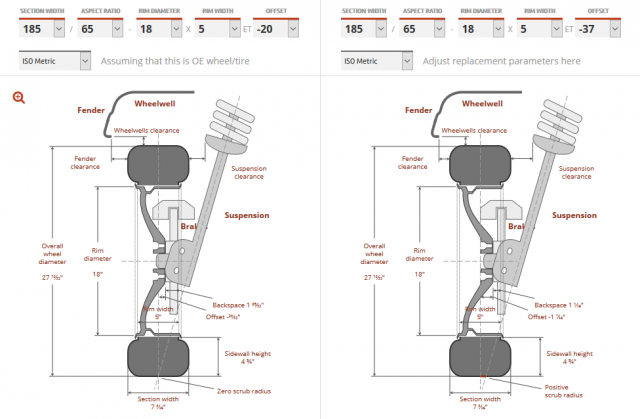

For those who cannot visualize the difference between a Racestar with -20 offset and these Forgestars with -37 offset... here you go:

I am too blind/stupid too decipher this info.
So, what does this mean?
-20 or -37 offset?
Which is better?

0 offset is the middle of the wheel exactly so a negative offset moves the mounting pad centreline toward the inner portion of the wheel barrel, and a positive offset toward the outside. Arguably a 0 offset is best as it even aligns the wheel over the hub centre and manages mechanical loading best, this is without getting into things like scrub radius and leverage issues associated with working angles.

I'm old and old school. I still love the "deep dish" look on muscle cars. Took me a long time to get used to the positive offset on newer cars. Just looked goofy to me. Unfortunately with the big brakes and offsets you can't get that look on the Challengers.....unless you get the widebody.
