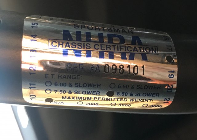

Marc,
What are you talking about, "getting too fast"? Is there a weight limit on an 8.50 or 7.50 cage?
3,287
10,440
Marc,

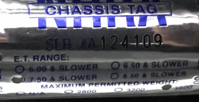

Yes there are weight limits on the cage certs. See the bottom of my 7.50 cert sticker. Max weight is 3600 lbs. IMG_2287.jpeg
5,498
4,529
It’s about “safety” (money)
cole3986
#1028
1,029
1,351
Lawrenceville
Hellcat, Demon, Trackhawk and project X,
Yes there are weight limits on the cage certs. See the bottom of my 7.50 cert sticker. Max weight is 3600 lbs. View attachment 131631
Yes, but was your car weighed? Mine was not BOTH times it was certified
3,287
10,440
No. The car wasn’t even completely together at the time the cage was inspected and certified. The cert just says the ‘cage’ meets the requirements. Not the rest of the car (including weight). That’s up to tech at the track. It’s not my idea. The weight limit is right there on the sticker. I’m just pointing out that, according to the NHRA, if my car weighs over 3600 lbs, it’s not legal with its current certification. The NHRA can change this if they want but they are continuously behind where they should be with stuff like this. Fortunately, tech is either unaware of what these things weigh or look the other way because they have never required me to weigh in as a part of tech.
5,498
4,529
We’re talking about MSHS though lol

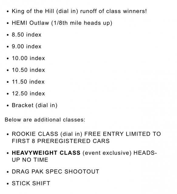

Buy an engine for a class that exists in 1 competition while getting rid of others. Was anyone running 7s in heavyweight? Looks like Heavyweight is still on the menu for Orlando only! An event exclusive next weekend! Good.
5,498
4,529
49,503
159,537
They really could of used different times for some of the classes. They don't have to to do 0 and 5. 9.70 or 10.30 for instance. No matter what classes you have or take away someone will not be happy. They could have done a 9.30 instead of a 9.00 and would have been more between the 2

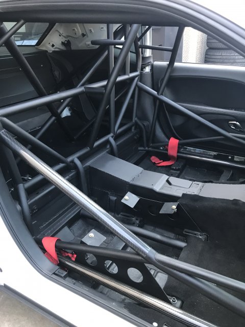

The difference is tubing size and placement (how many and where) The requirements are laid out in the NHRA rulebook. The difference between a 8.50 cage and a 7.50 cage is huge. 8.50 is nothing by comparison. I found a picture of my 8.50 cert sticker back when and there is no weight limit at that level for a modern muscle car like ours. The N/A is punched. The certs where you go faster than 8.50 is where the max weight limits come in. The 7.50 cert involves the floor, the overhead and even behind the firewall. I’ve shown this before but… once again 😵‍💫 IMG_2270.jpeg IMG_8107.jpeg
5,498
4,529
The difference is tubing size and placement (how many and where) The requirements are laid out in the NHRA rulebook. The difference between a 8.50 cage and a 7.50 cage is huge. 8.50 is nothing by comparison. I found a picture of my 8.50 cert sticker back when and there is no weight limit at that level for a modern muscle car like ours. The N/A is punched. The certs where you go faster than 8.50 is where the max weight limits come in. The 7.50 cert involves the floor, the overhead and even behind the firewall. I’ve shown this before but… once again 😵‍💫 View attachment 131653 View attachment 131655

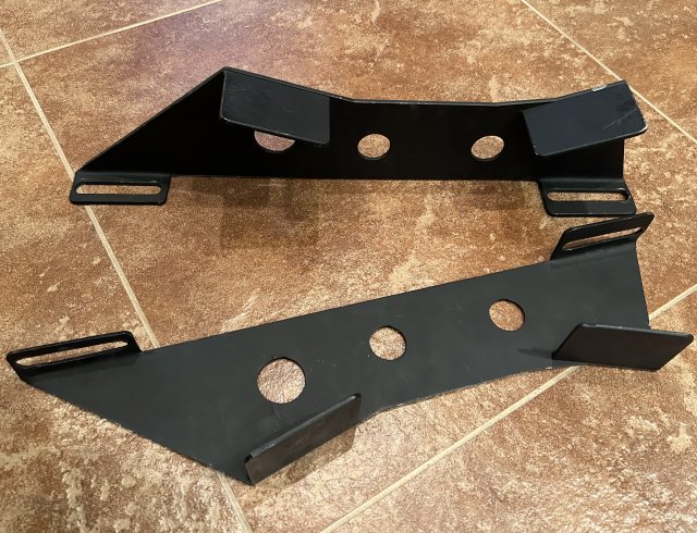

Do you have a source for those seat brackets? I’d like a set
Those are custom Carlin Fabrication brackets for Kirky seats. They are sized to fit the Hellcat floor points and sit under the seat. You can see that they are slotted for forward and aft adjustment. You need to drill the holes in the seat and brackets to bolt it down on top of the brackets. I have a set that have never been used. They were made for somebody else and are too short for me and were made for the larger 18” wide seat. The hight on these are not adjustable and this set would be best used for somebody 6’+ tall. That’s why I never used them. I wouldn’t be able to see out 😁. I will sell them for $150 plus shipping. If you want them…. I will take a return if they don’t work for you as long as you don’t drill holes and you cover the return shipping. I just don’t want to be out of pocket for a trial run. IMG_6247.jpeg

Those are custom Carlin Fabrication brackets for Kirky seats. They are sized to fit the Hellcat floor points and sit under the seat. You can see that they are slotted for forward and aft adjustment. You need to drill the holes in the seat and brackets to bolt it down on top of the brackets. I have a set that have never been used. They were made for somebody else and are too short for me and were made for the larger 18” wide seat. The hight on these are not adjustable and this set would be best used for somebody 6’+ tall. That’s why I never used them. I wouldn’t be able to see out 😁. I will sell them for $150 plus shipping. If you want them…. I will take a return if they don’t work for you as long as you don’t drill holes and you cover the return shipping. I just don’t want to be out of pocket for a trial run. View attachment 131710
These Are literally perfect for me, I have the 18” seat. Sending a PM, thanks!
