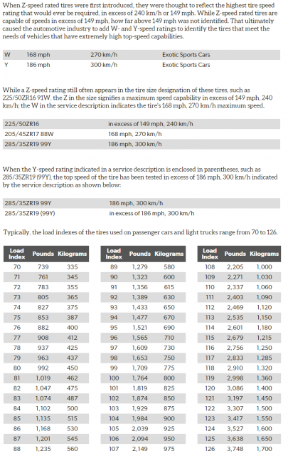

Was thinking again about tires since I now have my aftermarket wheels (see DGatzby's thread "Aftermarket parts - what works and what is a waste of cash?") and remembered this tire thread. Today I googled questions about load ratings, since it seems most replacement tires for the Pirelli's on our Hellcats have lower load ratings. 107 is our car's tire load rating, but I had trouble finding any of the tires experienced recommend in that 107 rating. You see a lot of 104 load rated tires. Speed ratings don't seem to be a problem - almost all the high performance summer tires can be had with the highest speed ratings.
Somebody posted this PDF chart on another forum. It is a guide that allows for lower load rated tires to be inflated to higher psi's, which increases their effective load rating. In the case of our heavy cars our stock special Pirelli's are 107 rated and support 1,946 pounds at 32 psi - up to 2,149 pounds at 36 psi. According to this chart a 104 rated tire inflated to 35 psi has almost the same support of the 107 rated tire at 32 psi. So, for what it's worth, adjustments are available.
20,159
I never skimp on load or speed rating.

Hi Magnified,
Yes, that is good advice.
To throw another muddy-the-waters concept into the discussion, that chart has an "XL Reinforced" section. I checked the load rating again at Tire Rack for the Michelin Pilot Sport 4S tires I want. These front Michelin's in size 315/30-20 are 104Y, and have an XL in their description.
https://www.tirerack.com/tires/tire...R0PS4SXL&vehicleSearch=false&fromCompare1=yes
It would seem this specific tire should be referenced in the XL Reinforced section for maximum loads at various psi's, not the standard section of the psi adjustment chart. I don't know the answer to that. Anyone?
Looking up the "XL Reinforced" values they show a significantly reduced load rating at a normal psi of 32 compared to a 104Y rated tire in the standard tire section - and you only get up to its maximum load rating of 1,984 at 42 psi (vice 36 psi for a standard tire). If this IS the case then these tires would probably never be mounted by a tire shop - for liability reasons.
The bigger rear PS4S 345/30-20's have a load rating of 106Y, which is almost the "legal" rating posted on the door frame of my car of 107.
I doubt I'm going to run my car on any tires I buy at their maximum load, exerted by the pure weight of the car (and me). But HPDE maximum cornering will exert heavy loads on the tires, especially the front tires. I read that part of the required load rating of tires when they marry them up with vehicles is for "evasive" maneuvers.
Maybe somebody here on the forum who works with tires can provide some more definitive perspective.

Switching up tire subjects a bit, but related...earlier in this same thread I learned about load ratings. That was an "ungood category" surprise! Michelin Pilot Sport 4S tires, rated at (104Y), as are your Cup 2's, aren't appropriately load rated for our heavy Challengers which call for (107Y) load rated tires. If you look up buying replacement stock Pirelli's you'll probably still see, as I did last fall, that Tire Rack only lists the summer stock tire as having a (104Y) rating. More WTF! Last fall I could not find a way to order online a (107Y) rated Pirelli stock summer tire in 305/35R20 size. And in this thread a poster reported his stock summer Pirelli's ARE rated (107Y) on the sidewall, which makes total sense, but then why no retail replacements in (107Y)? Fuck it, I don't want them anyway. But I WOULD like to be able to find better (107Y) rated high performance tires for my new wheels in the sizes I need - and that right now seems an elusive hope. Fuck me.
There is a questionable workaround for (104Y) rated tires. By inflating (104Y) rated tires to 36 psi (cold), says a chart a poster in this thread referenced, their rating would escalate to match a 107 load rating. The maximum psi is 50 - so some room there - but they're going to heat up from 36 running hard on a curvy track. Sounds like a better option would be letting HPDE road friction and brake component heating raise the tire temperatures - and pressures of at least 36 psi. Like dodged (Ha! Pun!) replies from Dodge, the manual warning's legal reading for tire load ratings is worst case - it assumes a car loaded to the Challenger's maximum gross weight - not a car with a full tank of gas and nothing else in it but two adults. But, hey, looking at the manual just now there is ANOTHER warning. It says prolonged driving faster than 75 mph at maximum car weight may lead to catastrophic tire failure even with (107Y) rated tires. Hmmmm, wonder what prolonged driving at 80-130 mph, and cornering near the coefficient of friction limits, even with just my fat ass in the car might result in? And with (104Y) rated tires? The devil is usually in the details, which is why I want to know details. Fuck with one performance parameter here, maybe suffer a fucking serious consequence over there. Worst case maybe the consequence is a fireball.

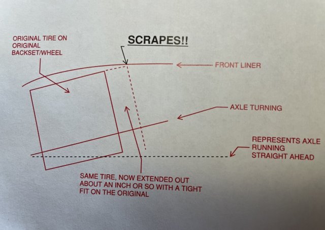

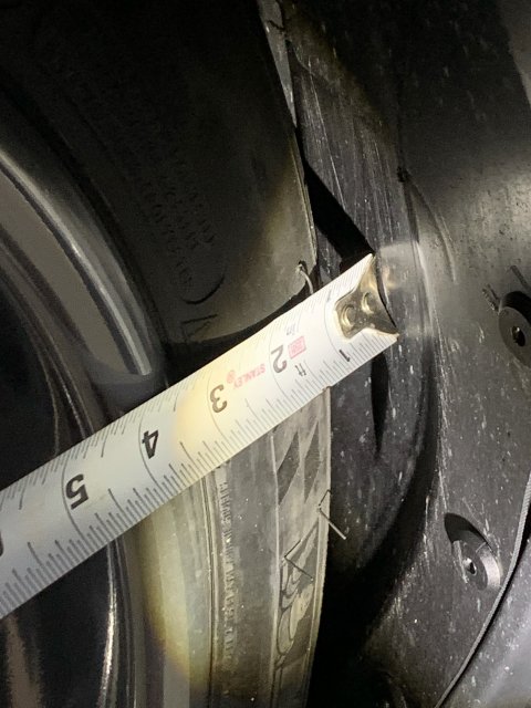

I may have a unicorn, but a 305/35 rubs the front liner on a staggered 11” front. They wore/blew four different push pins off besides scraping my liners. I have told you, written you about that. Shared pictures with you to help you. Oh, also the rear front liner catches some rub also! That is why I just unexpectedly spent over $1,000, on shorter tires. Why else would I do that and remove $1,000 of perfectly good tires? 305/35’s will only work on the OEM 11” wide wheels on my car in the front.
Frustrating? No. I just don’t like repeating myself multiple times. Now you want info and you want to debate what I have told you AND TOLD BIZ in public? ASK biz why he was so worried about a 12” front, and only made one wheel for fit. Ask him about the confidential photos I sent him.
Here! No longer confidential, you want public info.
Here everyone, here is a picture of a 325/30 BARELY CLEARING when you turn the wheel. Note the rub - scraping marks from a 305/35. It got even worse last year and I could not allow it to continue. This was taken early last season. You stagger out an 11” wide custom wheel too far (to match a 12” wide rear) or use a 12” wide wheel up front and this may happen to your car with a TALL 305/35!
Go look at where your 11” wide front sits relative to your 12” wide rear. Same spot - staggers out to look right. Go for it. Others can help you.

For the visually and mechanically challenged. Sometimes a diagram of a problem helps.
