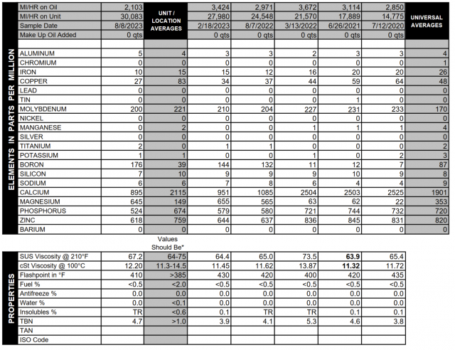

But I present it as an interesting case study. I've done this for 30 years on my engines, over the life of 6 vehicles, with the last 3 having the oil analysis behind them to show that copper, the primary component in bearings, being low. Included in there is my HC, which has been run hard at times.
Oil analysis from my Power Wagon 6.4L that has endured this craziness:
Note the copper that is 1/2 that of the universal averages (other people's 6.4s), and further that it has been on a steady decline since ownership (compare current with location average)
Now, the obvious problem is, YOU don't KNOW what THEY did. Again, read my first statement.
