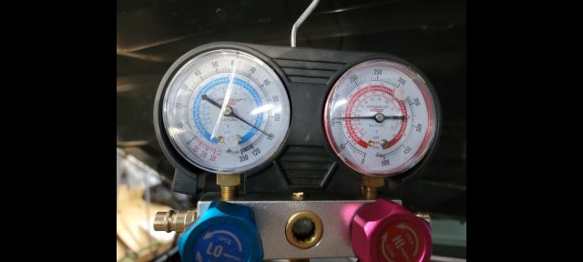

I think this pic shows what youre saying. Sane on both sides. The only issue is this is with the car on, ac on, clutch engaged and spinning. Spoke with another person and they agree it could definetly be the high pressure switch so ill comb over that when i get home.

I see what you mean now, hot that is a possible static pressure. Are you sure clutch is engaged? Is the center portion of the pulley spinning with the outer portion? If it is it’s sounding even more like the compressor took a slug of liquid Freon and broke.

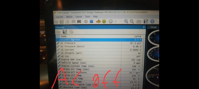

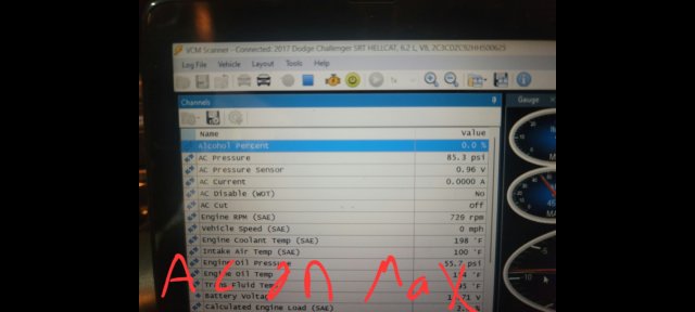

AC on, everything spins.
AC off, the clutch stops spinning
Attached are two pictures of the Gauges. One with ac on and spinning. One with ac off and not spinning.
Same thing if i unplug the pressure switch

Bare in mind this is only with 2 cans of freon in it after vacuuming it down. I got 2 cans in and saw the low pressure side jump high so I stopped.

Pictures worth 1000 words. You can see where were at now.

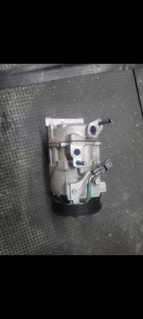

Fresh compressor in the AM. We shall see.
