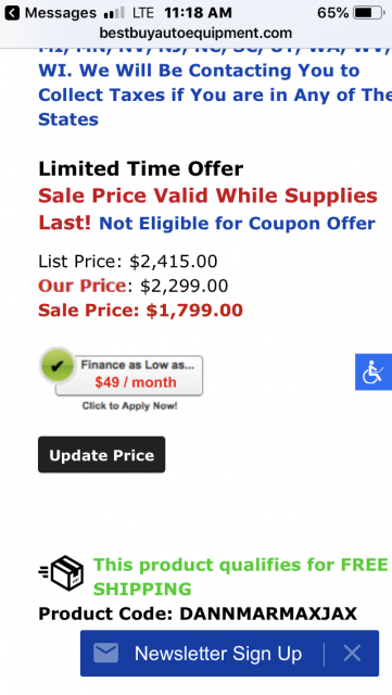

Car lift, 6000 lb $1800 free S&H

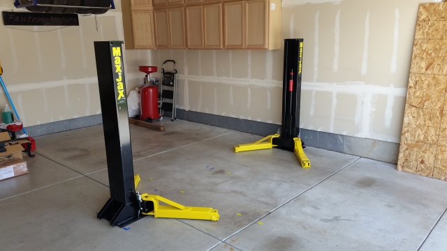

Are you selling because it did not meet your expectations?
My floor is too thin...

How thin is to thin?
14,751
45,291
3-3.5"
4" is minimum
6" is recommended

How did you gauge the thickness by drilling?
14,751
45,291
Test holes, section of straight coat hanger with a 90deg hook on the end of it.
19,092
41,571
Your correct...even 4" is somewhat marginal..but then I have a tendency to over engineer all of my projects..I have a 2 post lift..and a single post cantilever lift...both rated for 6000 lbs...my garage floor 6.5" thick..and floor to celing 10 ft 6 in….and I was on site for the pour..and inspite of this...still walk around them with cautious enthusiasm as hunter would say...
