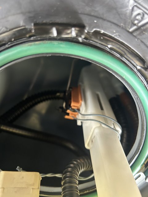

mechanic got the tank out, found out that the secondary sending unit was broken. Not even the whole unit either. Just the orange bracket and the fuel level arm. View attachment 181304
