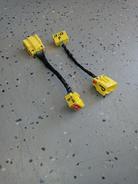

I took the info that Pete posted in the other forum and info I learned from members buying full on Hellcat Harnesses for me to cut apart and learn from, and now I can now make bypass harnesses for 2015 - 2019 both Pass and Drivers side. I am now making them with all resistors. No seat belt buckle needed anymore. So, they are cheaper to build and more compact. I also make the Windshield Washer Bottle level foolers if someone wants one of those. All this does is make the AirBag light in the dash go out. So, if you are like me and do not like warning lights on. The main reason I got involved in this is because you may not pass Tech at some tracks with your AirBag light on and my Friends and Forum Members were asking me to make them. My local track, Irwindale, will not let you race with the AirBag light on.

I also can fix that. As much as I would like to, there is no cheap way to do it. I tested out several methods and unfortunately there is no simple and cheap way to do it. The reason is, all the motors in the car use PWM. So you must include the actual module.
I can restore the Heated and Vented OEM Drivers Seat (when removing the Pass seat). This should include the heated Steering Wheel function. That costs $325.
I can restore the operation of the Power Tilt and Telescoping Steering Column (when removing the OEM Drivers Seat). That cost $350.

You can use newer Challenger seats in an older Challenger and all the airbag stuff will still work. Years are on the connectors. On the driver side I passed through the Power and Ground so the power driver seat will still work (but no heating or vent etc.)
