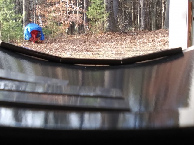

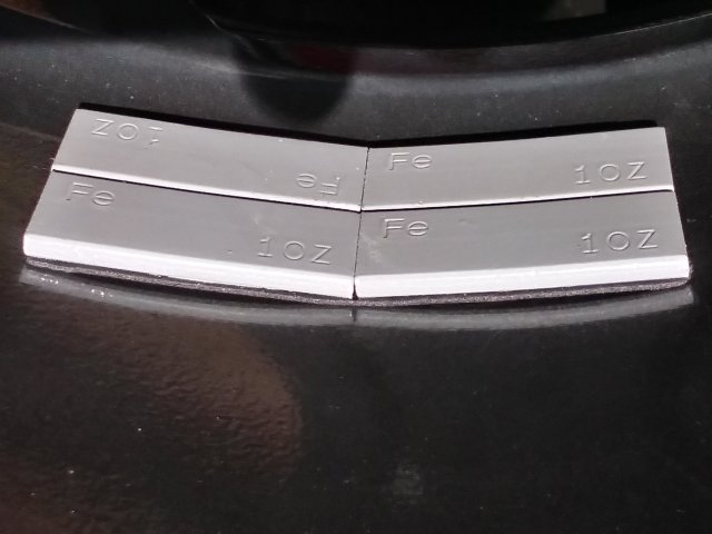

Just had the DR's balanced, they used 1oz weights, they only touch at the ends. I don't like the way this looks, I figure I'll pull them off and replace them wit 1/4's. Just wondering if the real racers out there think I'm doing the right thing.

Put duct tape over them.

never seen any that big. They not know the wheels are round:unsure:
I would replace them with 1/4 and find a different shop in the future

He can use a rubber mallet and then cover with duct tape until he gets them redone.

The weights are steel, the wheel might very well yield before the weight.

I thought they were lead? Heavy, flexible metal.

This was the "good" shop, these were the guys that saved me after the "bad" shop f'd them up. Minor thing to swap to 1/4's, thanks.

Apparently they are mostly or all "lead free" now, I guess they are afraid some will fly off in Alligator Alley and might get eaten! :LOL:

That's why I duct tape them on. Stops them from flying off at 140 mph and damaging the car.

Just a quick tip: you can put duct tape down first then stick the 1/4 weights on the tape. The tape peels off the wheel nicely when it is time to rebalancce or replace. Put some over them as well like Dave said so they won't go sailing at speed.
