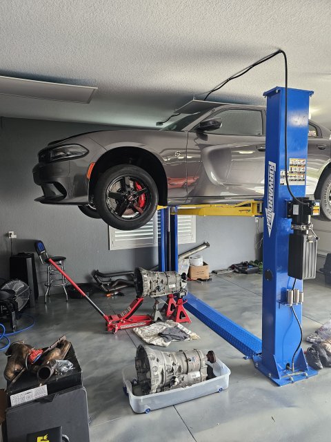

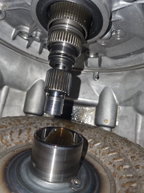

Back up and running, thanks to David Starnes @ D & B Automotive. We broke our input shaft in the transmission racing at Rockingham. David stepped up and built us another HP 90 Extreme trans with all the best parts!! Extra Alto clutches and extra high performance steels for each drum, billet E-drum as well as the extra tricks he has learned over the years. David we thank you for warranting the trans when most wouldn't do so, can't wait to get back to the track! On another note our broken trans was in great condition after tear down other than the input shaft. We beat the hell out of that transmission for a year and half of racing and lots of 8 sec passes. Also we got a Sipple’s Speed & Performance custom billet tourqe converter from Jon Sipple to replace our stock TC. I believe we broke the the input shaft because the stock TC was locking up bad at 1400 to 1600 rpm on the logs. Not flashing at its normal 2400 to 2600 rpms. Just want say thank you to David for being an awesome business owner and more importantly an even better friend for looking out for us!! We do all of our own work on the car including the engine rebuild in a home garage. We are truly thankful and have enjoyed your friendship over the years. Also thanks to Jon Sipple for the custom billet tourqe converter at a great price. Can't wait to see what we can run with the new set up!! Stay tuned... 20230704_202910.jpg 20230806_113239.jpg

Awesome! Love that lift! How high are your ceilings? I used to have the maxjax, raised 48”

This is my good friend's garage. Only couple blocks away. Ceiling is just over 10' 6" just enough.

Still a huncher, but better than working on the floor.

Yes, found a rolling chair with a tool base on the bottom to roll around under the car. It's really comfortable, works out great. Way better than the floor!
