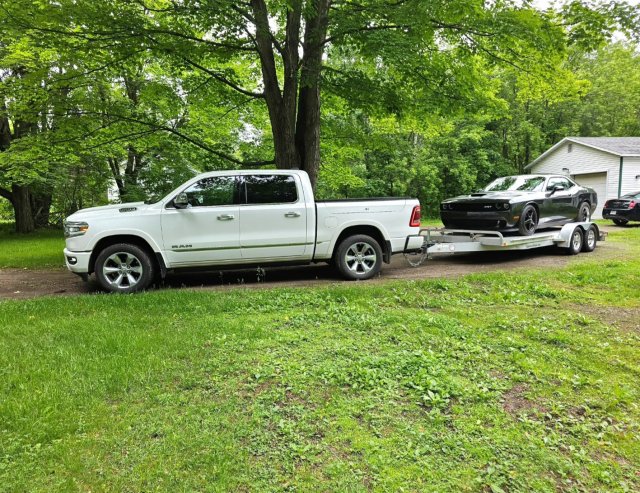

My 18' (technically 17.5') 10k Featherlite is 1585# I only bought it for when I want an open trailer behind our 40' pusher. My real point though is I towed the road runner all over the place prior to that with a 1997 Dodge Ram 1500 and it did well and that was with an older steel 18' tilt trailer. Most modern 1500 should have no issue towing what you want to tow.
View attachment 121419 View attachment 121420
Also great info. WD hitch?
Great car BTW! :)

Good info. No WD hitch?
No never on the open, I do run a 24' Pace that I later put behind my 3500 Ram and I do run a W/D on it.

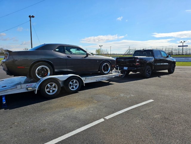

Yes I did back then with the stock 1500 suspension. Since then I’ve decided I prefer airbags. I’m towing the car now in a heavy 40’ tag with a 2500. I installed Air Lift Airbags and do not use the WD hitch. Much better.

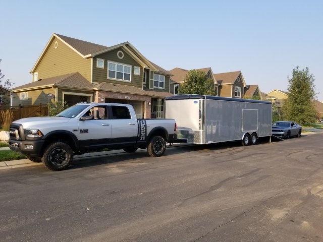

2017 Power Wagon 6.4L 2500 w/ enclosed trailer @ about 10-11k gross.
The reason I think this is applicable to your question is this setup is 3-4k over max towing for this truck, and with the Power Wagons off road suspension, towing was "interesting". Tongue weight was super important (as well as trailer balance).
But it worked well enough, but I'm not sure how many mountain passes I'd want to climb.
Make sure your brakes are in good working order and your brake controller is properly tuned for your trailer. I figured out afterwards that my controller had been set on "medium" instead of "heavy" for weight, brakes were MUCH better when set correctly!

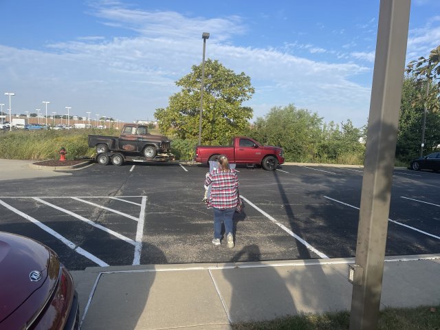

Not my HC but we used my little baby regular cab 1500 express to pick my wife’s 56 Chevy 3100 up in Kansas and tow it home to NW Ohio (880 miles one way) Did this about 500 miles after I replaced cam and lifters in truck and had 188,000 miles on it. Now it’s right about 200k on it and just did all the suspension and wheel bearings two weeks ago.
Buddies trailer and I think he said it was right around #2000 lbs, it’s all steel with steel diamond plate decking. I’m not sure what truck weighs but it’s all there, body, engine, trans, glass and everything.

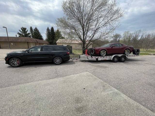

My two1500 that I tow my cat with. The first was a 3.21 geared truck with 20's, the second has the 3.92 for higher weight limit and 22's.
Either one has been awesome.
No weight distribution hitch and both trucks tow nicely. They do have air suspension so that helps. Screenshot_20231121_123704_Gallery.jpg Screenshot_20231121_123601_Gallery.jpg

If you have to tow with a 1/2-ton, a good WD hitch is almost necessary, I think.
Adding air springs doesn't do a thing for moving weight to the front axle, and can only help keep the tow vehicle level. That's not my opinion but basic physics.
Having towed with most everything between 1/2-tons and a Peterbilt, and for many hundreds of thousands of miles, I have an idea of what works well. And maybe the most important thing is that the tow vehicle should have a long wheelbase and be heavy. Long and heavy basically rules out a 1/2-ton right away.
Also, I really don't care for those inflated J2807 test numbers that the manufacturers brag about. Instead, I prefer looking at the size of hardware underneath, then ask "How long would this stuff last if pulling X,xxxx lbs.
That BULL's 2500 is rated lower than his Durango should be proof that those ratings are unrealistic.
