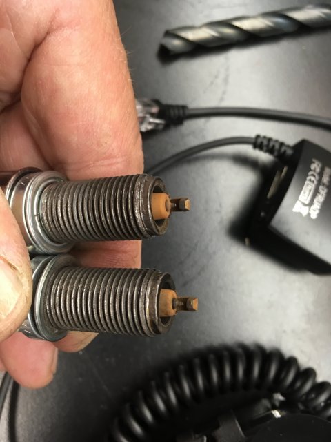

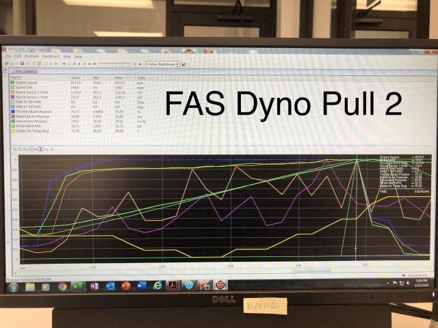

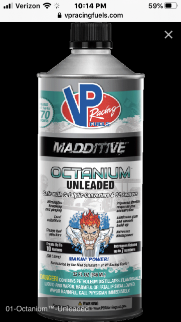

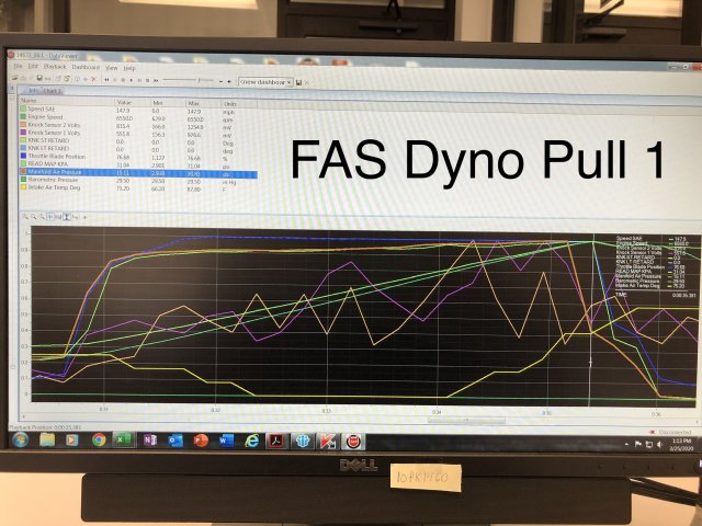

I switched to Octanium Unleaded this season and like it so far. Proven knock suppression via data logging knock sensor bolts. Cat and O2 sensor safe, doesn’t foul plugs. 1 QT at 22$ raises a tank of 93 to about 100 octane.
I’ve used Boostane before and was sold on Octanium with a bad tank of gas that Boostane didn’t help STK but a qt of Octanium took knock sensor volts from 1890 millivolts to 1300 millivolts, SOLD. I still use TORCO in my NOS Capri but no sensors or cats to worry about on it
3,319
7,832
O, BTW making 860 rwhp on 93 at 17.5 psi of boost on a 2,85 Litens with a qt of Octanium for insurance, the data says it all. I test all kinds of products, this one gets 5 stars

That is good info but the can says treats 10 gals. So at 19 gal our Challengers would need two ($44 or almost 2) at a fill up. You use one in a tank and have that success your showing? (1890 millivolt down to 1300 on knock sensors) or you add to 1/2 tank @10 gals.?

Yes, one qt at fill up, usually about 12-14 gallons, so probably 97-98 in the tank with repeated use.

Are you saying the VP didn't leave the orange film on the plugs? You pulled plugs and inspected?
Was there any film at all??

Wondering that myself Bull, so I just checked the website product description:
Product Description
Octanium™ Unleaded is formulated to provide an octane boost – up to 7 numbers (70 points), increasing horsepower. It is safe for use in cars and trucks with both catalytic converters and 02 sensors. Octanium™ Unleaded eliminates knocking and pinging, cleans fuel injectors, eliminates gum and varnish build up, and improves throttle response and acceleration.
  • Safe with Catalytic Converters
  • Safe with 02 Sensors
  • Eliminates knocking & Pinging
  • Lead substitute
  • Cleans Fuel injectors
  • Improves throttle response and acceleration
  • Eliminates Gum and varnish build up
  • Increases Horsepower
  • Treats up to 10 gallons
  • Increases Octane up to 70 points
Claims to be safe with O2 sensors & cats, so maybe this won't foul like the other product?

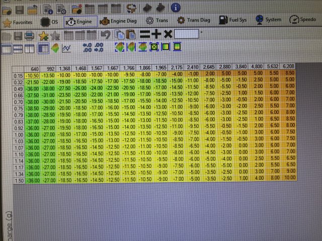

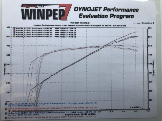

@16GoManGoHC2 you don't show timing advance in your posted logs, how much is it? What was different on the dyno pulls going from 806 to 856?
Winter blend Shell 93 I had to drop my timing down to 10 deg at max aircharge ~1800mg (about 17.5psi). During summer months on summer blend Shell 93 I had it set to 12 deg.

Added FAS inlet plate to my blower, netted 50 Hp gain, unfortunately it cost me my original blower as the plates are flawed and FAS won’t admit to fault, claims installation error. I just bought another plate, their bearing bores are .003” tighter then they should be. Come to find out I’m not the only one that got one like this.

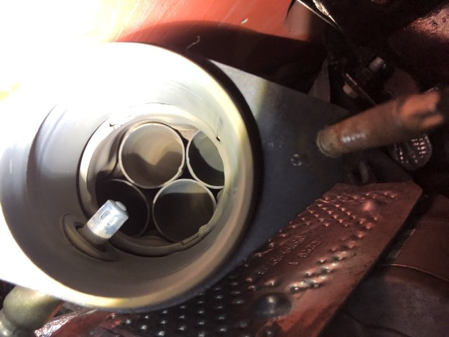

Yes, pulled plugs, very minimal residue, dropped exhaust too, minimal in there too.
0AC41EA8-853F-4655-8A9D-658006812C5F.jpeg 568EEB98-4D81-4DAD-8019-1965362A92E8.jpeg
@Speedy!
Sorry, I couldn’t figure out how to find what you asked for before, is this it??
