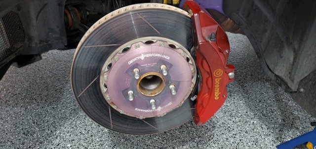

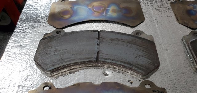

The comments about braking style are purely from things we've discussed over the past few years, as well as when we were at the track this summer. I was mainly catching you in Turn 1, 2 and braking for Turn 3. During the slower parts of the course your speed was about the same as mine. You had to hold back on the straight due to your alignment issue. You know I've had that same issue in the past. It's damn scary.
In addition, regarding the brakes, here are pictures of my front calipers and pads. The DTC70 front pads were new for that day at Brainerd. The caliper discoloration is due to heat, I believe mostly at Road America. Heck, Kevin Wesley showed me that his rear calipers are discolored like that too. :oops:
Regarding weight loss, all I've done on my car is remove the back seats. I added the Demon harness bar, so half of that weight is right back. Noone would use the rear seats with that harness bar back there anyway. I also removed the trunk floor panel because it interfered with my Petty rear shock brace. and I didn't want to cut it up. The other items, like the front sway bar and front rotors you've done too. I think you also have the lighter Demon rear rotors that I don't. ;)
But sure, it's all in good fun. I enjoy learning things from you and I think you are the same.

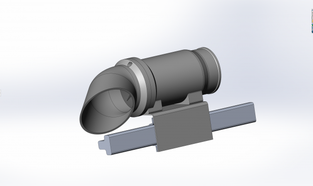

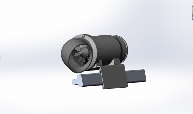

5.5ish
80ish watts
Not too bad

Ok. That's better than what we initially discussed I think. I still have my 2 I plan to install by next spring unless you have something ready before then.
