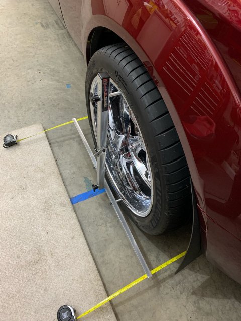

Got the QuickTrick alignment kit yesterday. https://www.quicktrickalignment.com/shop
I don’t know if anyone else is using this instead of paying for alignments? It basically paid for itself already! Between what we pay a shop, make time to take our cars in, waste more time picking it up and finally giving them a credit card to see the money go away forever.
Being an old carpenter (bet you folks did not know that about me)and still enjoy doing stuff with wood when needed around here, this device was a breeze. As usual directions are for dummies, so it took about 10 min to look at put together and basically then take it out and see how bad I could screw up the chrome wheels. Kidding, the wheels are fine. It has a great little lip that slips on the outside of the wheel. Tomorrow when I set it up for some camber checking, I’ll take more time and at least get some tape on the edges. That may help it say it place also. But here is a picture.
The toe process is simply done with two measurement tapes, which they give us. They have slots for the tape. It is graduated in imperial for us old smart people and the foreign favorite metric for the young trophy winners. I prefer 1/32” or 0.0313” instead of 0.79502 mm. Why TF do I need two different ways? Anyway, I have not been so pleased with something for a long time. First time I did the rear in a hurry, it was off. I was pissed. Ate dinner, complained, threatened. The calm one kept telling me to not make a big deal. So she agreed to help quick to set it up on the fronts for a check also. It took maybe 5-10 min to set it up up front. I immediately notice that maybe I was not careful inserting the dumb end of the tape(s) right in the slots.
I carefully do the front. I find the front off by 1/8”. Actually on the money, toe-in. Ok. Check the alignment chart from the dealer. Did some of that old trigonometry, and damn, it should be off exactly 1/8”! I suddenly become pretty damn confident.
We re-do the rear. I am a near expert now, set it up twice now, right! I’ll be damn, the rear is not close, not even a guess, both sides nearly 1/32-1/64 just short of 83”, and both right on the same spot on both tapes! That toe is right on zero. The new AAD arms have the three notch bottom tab or their +1.5mm inserted. That is the longest length tab out of six sets. So I am waiting for the boys in KC at AAD to read their mail and send me a couple more tabs in case I want to dial this rear into more toe-in.
So I may just do two track days in the next two weeks! Stay tuned, because tomorrow I need to read the directions of the fancy level they gave us and get it to display the camber on each wheel. Then I get to change the front camber and play with it to check my work. I am never paying for an alignment on this car ever again. Happy days!!

Your kit is 2 brackets, 2 tapes and only the 1 digital gauge? Remember which part number you selected?
Eagerly awaiting the feedback on camber adjustments. I may just have to pick this one up but may go with a slight upgrade.
8,582
52,765
Thread Starter #99
It looks like a breeze for camber. I’ll detail that in the morning. I do need to read the directions on the electronic part of the level. It looks like you calibrate from the floor, hit a button, put it on the vertical rod and press another button to get the camber reading on that wheel. Caster up front looks like it may be more easy if you spend the cash on $200 worth of floor pads with the gauges for the turn angle. Otherwise a guy could devise his own way of measuring 20 degrees of movement left and right.
I got the Pro kit. 17-22” wheels for $299. Amazon delivered it in three days. You don’t need two levels, it is quite portable, it fits in your pocket, right. I don’t need a steering lockout. I went in, eyeballed the wheel, backed up and forward once or twice and just went with it. Eyeballed the tires on the exterior and was convinced it was straight ahead. The front toe came out exactly where they said it was for $100’s of dollars! The rear toe takes minutes now. Should never have to screw with it again unless for some reason I want to try just a bit of toe-in. But if it accelerates straight without scaring the shit out of me to about 165:LOL: I’m in! The 4S’s have hit almost that, so now it’s up to the Cup 2’s to get enough heat to stick. I may do a day at the track Monday, and it is to be sunny and in the ‘70’s so I’ll get it somehow dialed in yet.
