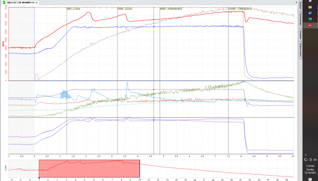

Btw, NO MORE laptops in the car logging. The FT600 ECU does all that for you. Stores five tunes and logs and stores your passes. And no more downloading and emailing your log to the tuner. With FuelTech, your tuner logs into the ECU remotely and makes adjustments, saves the tune and bam...you're right back racing!
Even people without a tuners background and training can read the logs, discuss with your tuner and see what's going on with the car.
Btw, FuelTech logs and makes adjustments by the millisecond and not some guess game adjusting maps. FuelTech tunes to real time data.

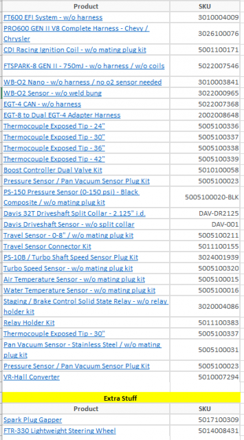

Good call out and FuelTech already has my build sheet for a Gen 3 Hemi and what's needed to order and install for the FT600.
Here is the catch. Not everyone buys all of the sensors. We wanted all of the sensors. LOL! More data your tuner has, the better he/she can tune your car.
Basic must haves sensors:
1. Oil Pressure
2. Fuel Pressure
3. Water Temp
4. Trans dumps (internal and external)
5. Crank case pressure
6. Driveshaft - must have in racing
7. MAP
8. Knock
Added sensors:
9. Turbo speed
10. Ride Height
11. Wheel speed
12. IAT
13. Pan vacuum
14. I know I'm forgetting some sensors...LOL!
Here is the list of my complete FuelTech FT600 kit:
We bought the remade wiring harness and then built our own sensor harnesses. Some of the basic sensors are in the FuelTech wiring harnesses.
