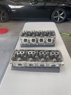

AlleyCat
AlleyCat
#1332
970
853
Oro Valley
16 HC Challenger
Thread Starter #25
Mechanic states they are very pretty!

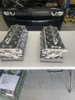

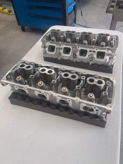

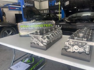

Thread Starter #27
Frankenstein stage two fully assembled with slightly larger intake valves. Once together it will get dyno tuned remotely on my mechanics dyno.
Make sure you let us know what the gains were!!

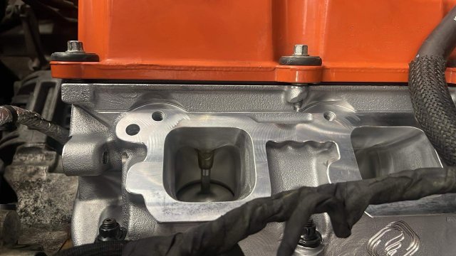

Thread Starter #40
