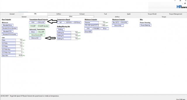

Thread Starter #41

Fired up the tablet and for what files were unlocked that I have access to...it appears that both P/N and Drive AC target idles are set to 750 (752 technically) at temperature. They start much higher during warmup. 1000 to 1300 depending on temp and condition.
I may have deleted all old copies of my open tune files because tbh I messed with them too much and always went back to the known good anyways. If I can't 100% trust my guy I shouldn't be paying him to do it in the first place.

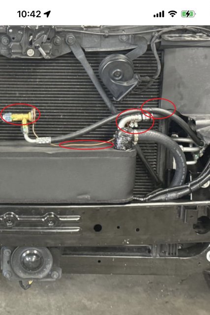

Thank you for your input and pictures, is the stock Intercooler and Chiller providing cooling for 2 turbos also? Once instructions are followed with the provided insulation and Active HX Bypass programming optimised you will lower Intercooler fluid temp. I would look into a bigger pump for compound boost since you have a 70* Delta. You also might want to upgrade to our Stage 2 Interchiller, you should look at our Stage 2 Upgrade while it is on sale.
As you can see in your picture insulation is missing, and the HOT AC hose needs to be moved from the Cold AC hose. It is normal when a soft aluminum AC fitting arrives bent to straighten it out also when a fitting needs to be rotated to rotate it. I discussed this with your shop and they agreed with me but had reservations about doing this while working with you. I offered to express a new hose and fitting but never heard back from them. The exclusive adapter pictured on the suction line under the hood provides no cut installation while keeping the hose out of the way and close to the OEM line.
Oh, where is your HX Bypass Valve installed? Any pictures you can send us would be much appreciated. You have the highest quality 100% bolt-on Interchiller Kit with Active HX Bypass available and at the lowest price!

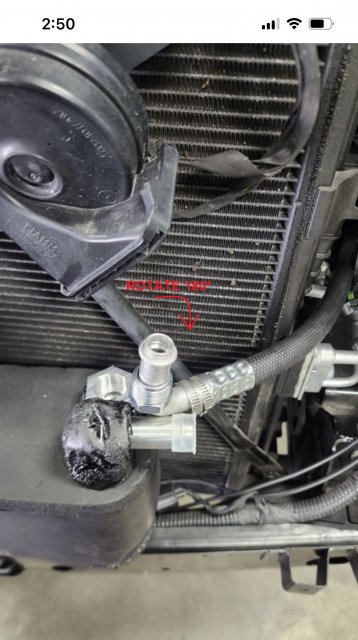

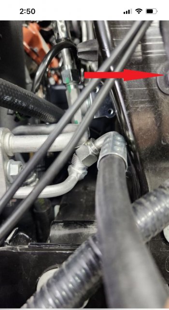

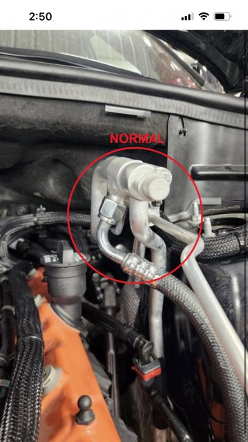

#58
Hey all. Longtime reader of the forum..
Shop is installing this kit on my trackhawk, this is the one made by Dave Spurlock. Shop has run into the following issue, pictures attached.
The fittings on at least two of the hoses won’t articulate with the hardware they’re intended for due to the directions/angles of respective connection points.
Mr Spurlock recommended we use a vice to bend the fitting to get it to articulate with the port coming off the chiller.
Anyone installed this kit before, did you run into this and were you able to bend the fittings?
View attachment 139654 View attachment 139655
