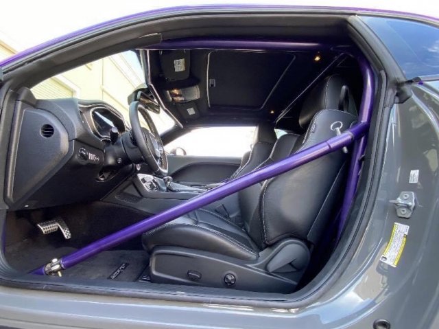

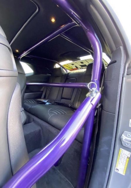

That and being allowed to run at a track that enforces the NHRA requirements. I know a lot of them don’t and there are people all over the country running eights at 150+ mph with a stock seat and a OE shoulder belt. Out west for whatever reason... the tracks enforce the rules most of the time and getting kicked out (or even barred) from a track after spending all that money to go fast is a waste. Shops like this one can fit a cage so tight inside the car that it is not a inconvenience. Removable or swing out door bars make it so in and out is unimpeded. The five point harness is a part of it and needs to not only be used on the track but the street also to keep you away from those overhead bars. A beautifully done cage is a enhancement in my opinion. There’s no need to tear up the car or do anything that isn’t reversible. Here’s a example of his work in the streetable catagory. 1987E589-4A52-431A-92EF-4C504A627200.jpeg D0A001E0-5C1B-426D-A587-276602798218.jpeg

This is really sharp, snug fitting cage that is functional for the street. In St. Louis, one of the high powered Hellcats got squirmy on the big end, almost hit the wall, then NHRA folks started to enforce. I personally was thankful for the change in their scrutiny of safety, from the jacket, helmet, to cages.
