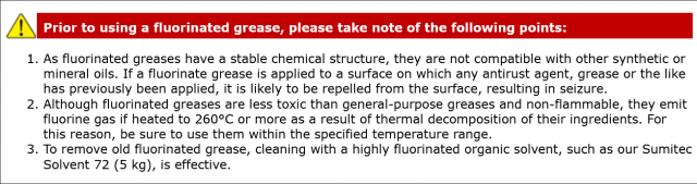

I'm not suggesting that the Krytox was the wrong grease for it qualities, but for its possible side effects and cost.

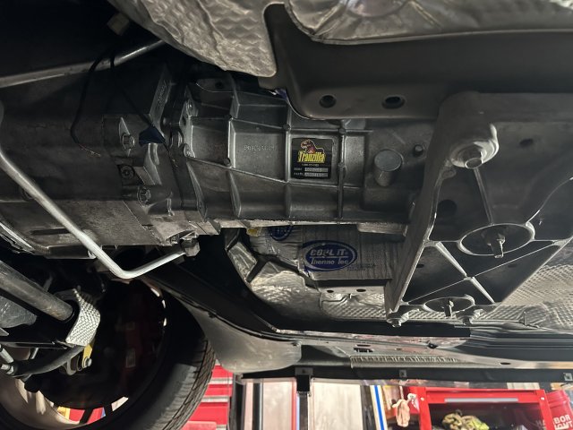

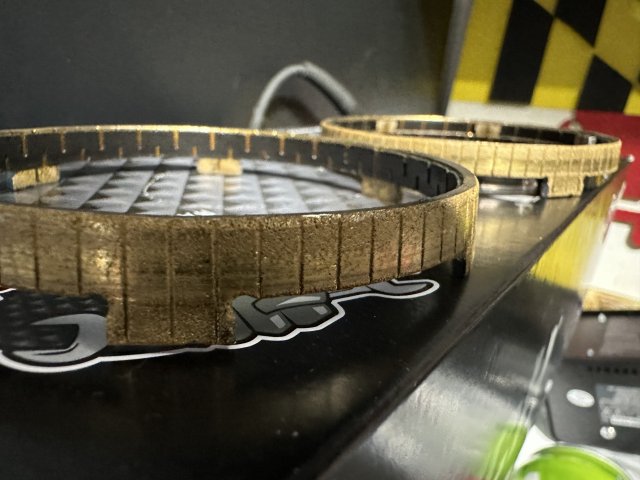

It’s been a long time I know but finally got this fixed. My 1st - 3rd synchros were bad. I gave it to Rockford standard and they changed the synchros and the gear ratio to 2.66 in first.
A little difficult to see in the pictures but that’s two of the synchro rings there, I should have it finished by tomorrow…..drove about 7 hr turnaround to NY today as I dropped it off rather than ship it.
Running RSG tranzilla synchromesh this time which they recommended. Looking forward to seeing the difference, and being able to shift the damn thing into third lol.
