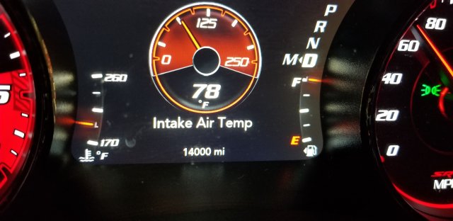

Just crossed over 14,000 miles on my 2018 Charger Hellcat. This car is my primary car and I am not afraid to drive it (parking is another issue [ohcrap]). Only real issue has been a slight road vibration around 77-80 mph, which was remedied by switching to PS4s. I didn't want the dealer driving my car around trying to figure the tires out...so I upgraded to PS4s.
Another annoying thing is performance pages (gauges) sometimes say their was an error/could not load. It usually comes back on at next restart, but the last time it took 3 restarts before it worked again.
Lastly, almost got the UConnect brightness settings for day and night dialed in. Night is slightly on the bright side and settings were grayed out last time I tried to lower...so will figure that out.
Really cannot complain overall...great car for the $$$.
