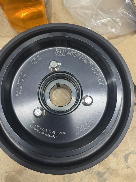

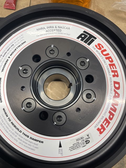

10% overdrive assembled and ready to go in
E4A195D3-E97A-4BA9-984B-AF9F02F4D5DB.jpeg F66DA3E9-3D1E-423E-B061-F19D8F2865CB.jpeg
killer chiller and catless mids arrive on tuesday, old SW stock. Have vibrant cel eliminators too. So order of operations. Suspension & midpipes -> test, killer chiller -> test, over drive pulley -> test, BMR expansion tank (4 weeks out) -> test, cage. Stay tuned!

Funny how the damper has a keyway yet our cranks don't have a key:unsure:
I had the same thought when I saw mine.
Maybe it will get on the car one day .

Do you have a ported blower? You also may have to drop to a 2.65. I think you are a 2.72 if I remeber right

I already have a pinned crank, I’m going to see if I can drill the slot instead of having to drill another hole in the crank.
Correct, I mean a 9.0 would be nice but if I don’t get there I’d be okay with that. If I go any smaller Im having the s/c sent out for race bearings, might as well port too.
