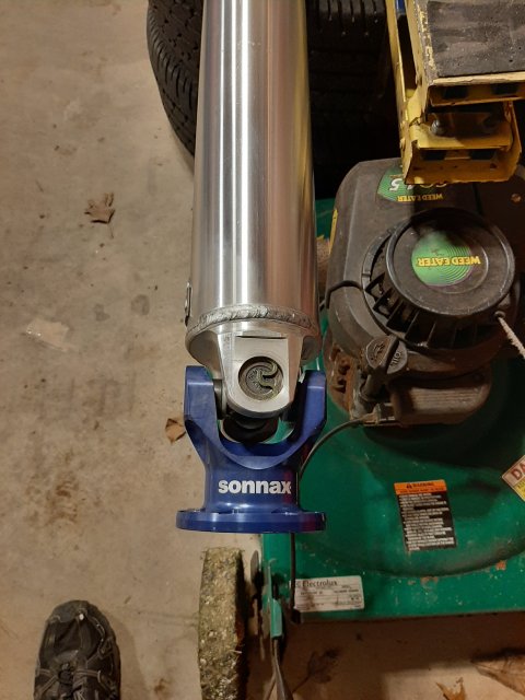

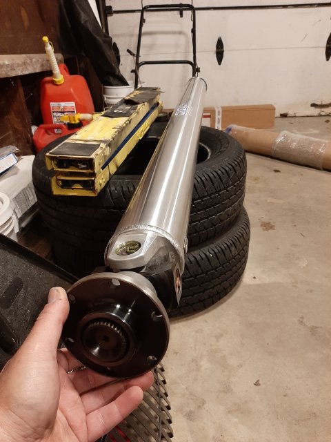

They no longer have the slip joint and boot on the shaft side of the u-joint.
Instead they have that same blue sonnax flange at the diff side, a solid 4" shaft the entire way and a custom splined slip yolk flange at the transmission.
Interesting. More pics please

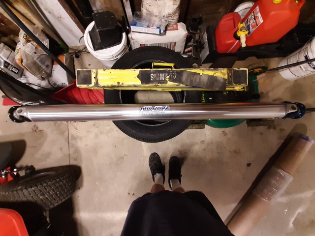

Only 2 I have until install.
