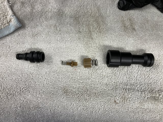

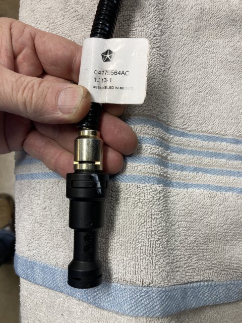

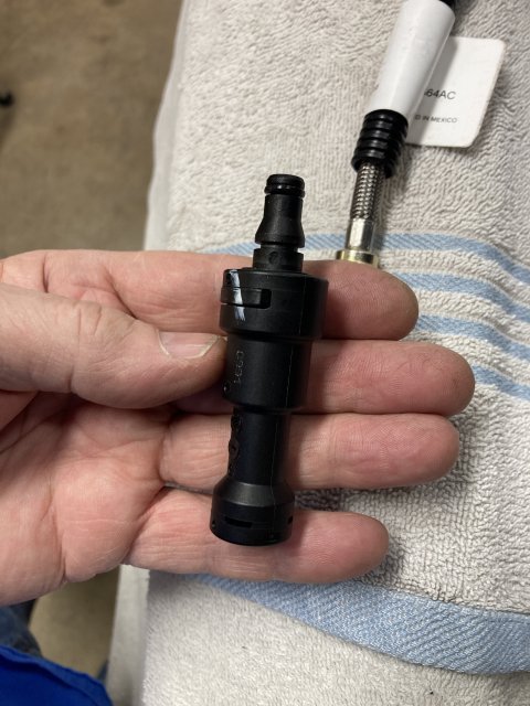

2A, did you remove that blue in-line thingy with a screw, as mentioned in a few tutorials, or what’s mentioned above, as the “real” cdv done by 16GMG?
4,836
11,694
22RENBS2 & 170
Thread Starter #24
I just pulled the blue restrictor and the rubber grommet. I didn't know about GMG's way until long after everything was done. I hope that's ok, I'm lazy, I prefer not to do what doesn't need to be done! :)
Seems to work great! Only the much easier start-off is clearly obvious, everything else is subtle.
Yeah, I had to use a screw for the blue thing, the pick was ok for the grommet.

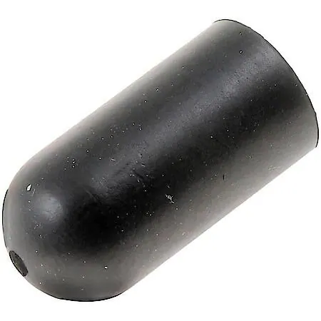

Biggest issue is: you need a 3/8" vacuum plug (cap)! No one would say that in the vids!!! Thanks BG!
