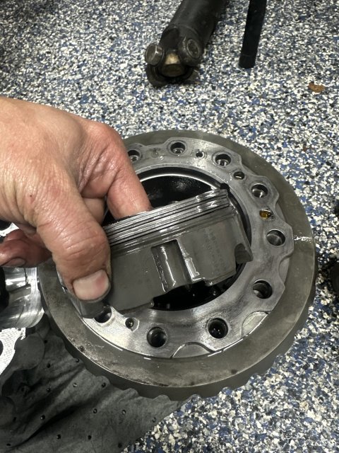

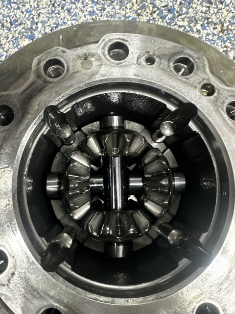

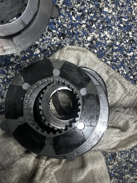

Just ordered my wavetrac thanks to speaking with @Hatermkr (also thats my diff he setup in the pics)

I have set up a couple. Nice unit. The clutch’s in a stock diff don’t have a lot of friction on them
Does the spline on the stub shaft have the same depth engagment as it does with the stock diff?
Yes to a tee
