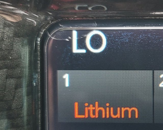

Just noticed my uconnect screen in the upper left hand corner is bubbling up underneath the screen, I have heard of this happening to others, anyone in here experience this?
Just figures, I just got my dash hydrodipped and now it needs to be removed again to replace this POS Uconnect head unit FML!!
Just the thought of having to go to the dealer makes me sick, thank God for extended warranty! Screenshot_20210613-105328_Gallery.jpg

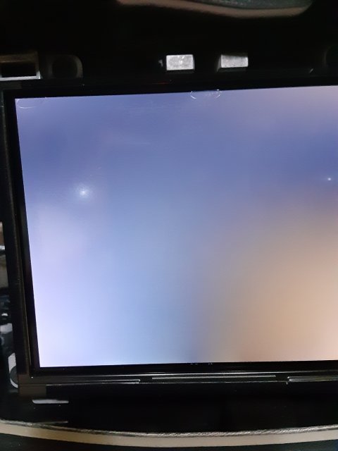

It's already getting worse, here's a picture of the screen the bubble in the middle has gotten bigger since yesterday, going to the dealer tomorrow so they can look at it. Resized_20210614_105945.jpeg

How hot is it getting where you are? Car garaged? Exposed to sunlight for 10 hours a day a work?
4,689
18,912
Mine was just like that, the 2 bubbles eventually joined up & that's when the screen began acting like it was possessed !
Took almost 4 weeks for them to get the replacement unit (late last fall), install was about 1 hour.

Hellcat is garaged, never gets below 60 degrees in the winter and no more that 75 in the summer, fully limo tinted except for the front windshield.
It's a weekend toy and really doesn't get used in the winter at all.
Off to the dealer in the am they just want to see it, I don't have to leave it there and I've already removed the dashboard to access it, I just got my dashboard hydrodipped and I just don't trust these guys to remove anything without scratching it up.
