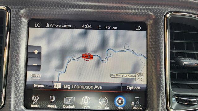

Update:
Upgrading from 17.11.07 to 18.45.01 fixed the clock... ...now lets just hope there aren't new and exciting things to worry about with 18.45.01... : (
