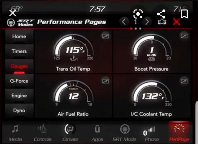

Have any of you guys been able to pull up trans temps on your HP90's?
I have tried in my '16 Challenger and get nothing but instructions on what to do when the trans overheats.
Octanewide
#988
1,154
2,204
House of power

Thank you.
Engine must be running to pull trans temps up on screen.
