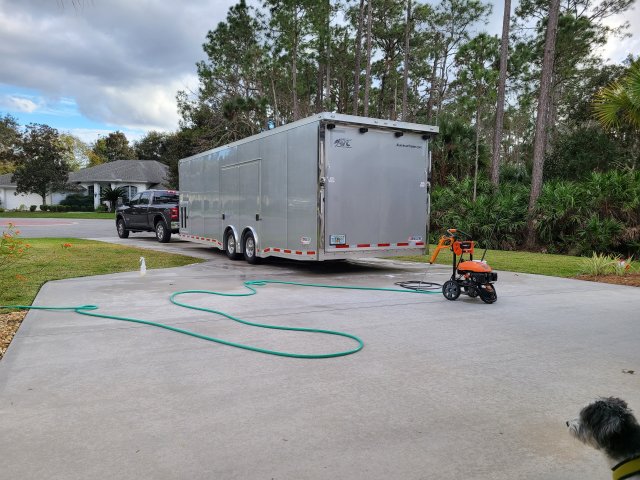

2000 lbs? Mine was rated for 10,800 lbs. It did a great job with this setup. I traded when I went with an enclosed trailer.

I have a 2500 now. It does an amazing job pulling the 28' enclosed trailer. This ain't my 1st rodeo.

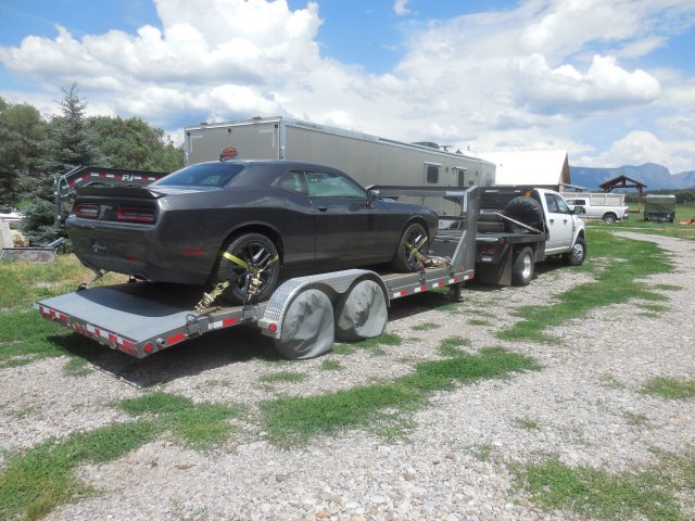

By now you know what my preference is. And not only do I have a significant tow vehicle advantage...there are fewer doors to drag around on the trailer. DSCN4478[1].JPG
Is it overkill to pull a single car with a 3500? Maybe. But I don't mind the extra safety margin one bit.

It depends on how you are going to use it. Mine is used for a daily driver and hauling the car and trailer. A dually would be a tough fit in my garage. It does a great job. The trailer is all aluminum for a significant weight savings.

In my case, the only thing the 3500 is used for is towing. Had a nice little aluminum gooseneck flatbed when all I had was a 2500, but the stuff I tow has kept getting heavier.
As you can imagine, the 38-foot (aluminum) toy hauler in the background is pretty much DRW only as it puts well over 4,000 lbs. on the coupler, as does the 32-foot flatbed behind it.
Sounds like you need a larger garage - and a nice 2-door for a daily driver.
