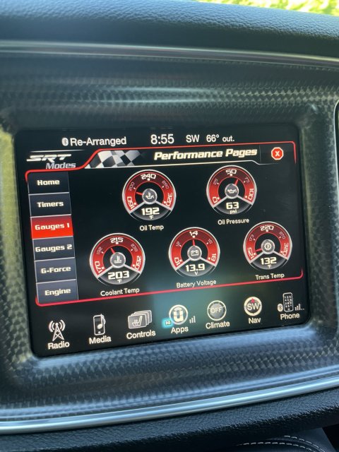

So after my last few passes at the track I noticed the car was not cooling down to the usual 192 degrees after a pass. I have a Jet Performance 10183 thermostat. While driving today, 66 degrees out, the car would not get cooler than 204 degrees. So a couple of things I’m thinking may be the culprit.
  1. Mechanical failure.
  2. Tune somehow has fans set for 204.
  3. Air bubble.
I’m ruling out #3 because this would have surfaced a long time ago… And I can’t see if #2 is the culprit as the tune is opaque from OST… if the thermostat is stuck, does anyone have any recommendations and should I go with a cooler thermostat if I have to replace it?

If it was stuck closed, wouldn't your temperature just continue to go up as you ran the car? Either way I think you are stuck having to replace it just due to the uncertainty of it all...

Does the JET tstat have the bleeder hole to keep at least some coolant moving? That would explain why it’s not boiling over more quickly.
If you get it to 190* and the fans don’t turn on (you’ll hear them), I’d check your tune - but I highly doubt they’re waiting for 200+ to turn the fans on, probably low speed at 170 and high speed at 190 or so. Especially if you’re running a cooler tstat and OST knows about it, they would adjust your temps accordingly. Hopefully you can hear your fans turning on when your driving and the temp is over 200* or your fans aren’t working properly. Check fuse/relay.
Having said all of that, if you haven’t changed anything at all, and this is a new and unrelated problem - either your tstat is frozen shut, or your water pump took a dump. I think you may be able to tell which by checking the temp of the coolant hoses going to the rad and leaving the rad. If they’re both the same temp (according to your hand or a thermometer) then I would think that your WP isn’t keeping up and you may have lost some blades. If there is a significant delta between the 2, your tstat is frozen…

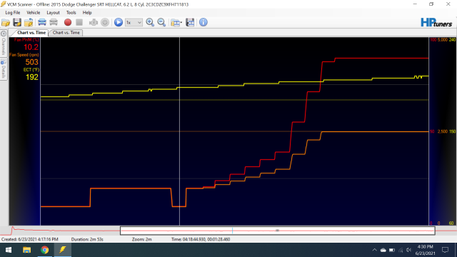

Have tools, use tools... Decide to setup a quick graph to log the fan pwm, fan speed and ECT to see if anything was amiss in the tune. 100% not the tune. As expected when I sent my tune to OST for refinement, I had the fans kick on at 185F in which they did.
Then an interesting anomaly at 192F the thermostat struggle bused, opened and then closed again it looks like:
Then from there the bleeder valve in the jet (at tdc) was able to prevent total meltdown. Waiting for the car to cool down to pull it. Gonna toss it in some 185 degree water and see if the filament moves. If not, then something else might be amiss like the pump, car is down, I repeat we have a code red, car is down!
