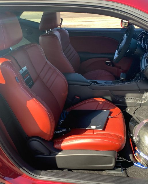

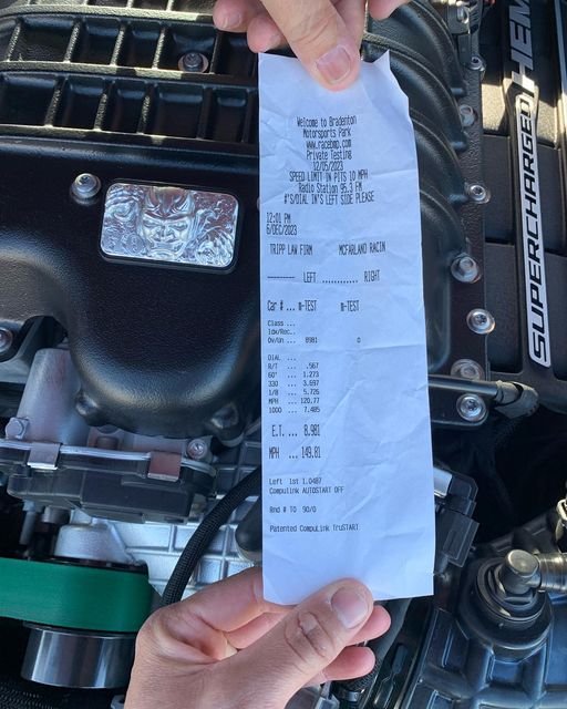

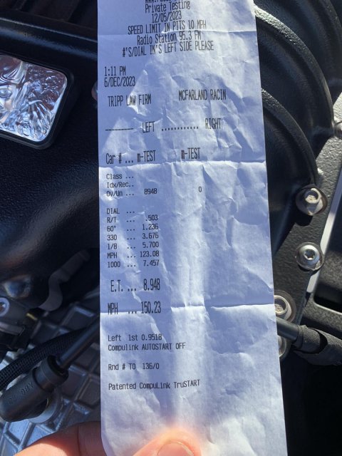

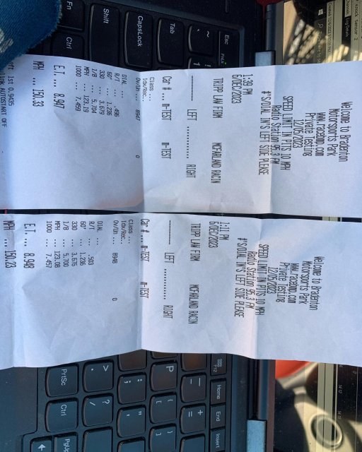

First in the 8s!! Demon 170 getting it done with interior and trans adjustment !!!! Huge thanks to Matt and @hptuners for continued support over the years!! Next we change tires and maybe take a seat out!! @goldbergsgarage @dodgeofficial @modernstreethemi @tricountymopars @volusiacountymopars #worldsfastestfamily #firstin8s #challenger #srt #gearheadlife
Changed the front wheels a stretched the shift out a bit…
Final update on the demon 170 today at BMP we ended up changing the front wheels and tires, which are very heavy to a proper skinny Weld, and definitely picked up in the 1/8… within, change the rear, and found that the rear is not very heavy and picked up nothing we went a 1.23 60 on a stock tire and backed it up with a Bead lock weld!! Dodge has done an incredible job with this car and it will go 8 more than once…. we will be posting videos a little later today @goldbergsgarage @hptuners @bradentonmotorsportspark @cleetusmcfarland @thatracingchannel @tricountymopars @volusiacountymopars @modernstreethemi #demon #demon170 #gearheadbuilt #gearheadlife #srt

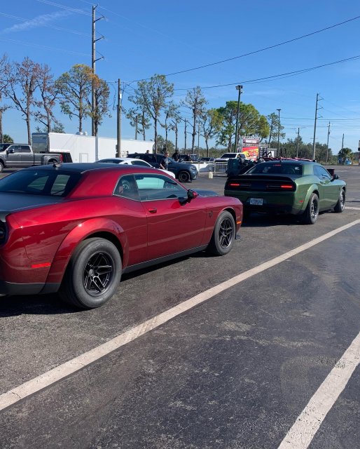

Who's cars?
5,406
37,140
41,505
180,073
Goldberg and Cleetus?
5,406
37,140
41,505
180,073
5,406
37,140
There's 2 car and both are tagged?
Actually the Red Demon 170 into the 8's is owned by Lee Sanders
41,505
180,073
OK. Nice guy. He has a 9 second hellcat tuned by gearhead so it makes sense.
Wondering why Cleetus was tagged?
5,406
37,140
The Green one belongs to
Doug Redd he also had a Green Demon and is a really Nice man!
41,505
180,073

Congratulations also goes to Lee Saunders. He was at Bradenton today (12/6) running his 270 mile Demon 170.
First pass was the 9.07 and you can see the rest of the passes in the 8.9Xs. Last 2 passes even cut a 1.23 60’! DA was said to be 400. No transbrake available due to mileage, so these passes were on a foot brake at 1k.
After the 9.07 pass, then had Gearhead Fabrications log in to tune the PCM/TCM, bump the shifts from 6,300 to 6,600 and adjust torque management. He kept the seats in the car but after the 2nd pass, they swapped to Weld skinnies up front, pulled the Harmon Kardon subs, and saw short track gains. They swapped the rears out too but didn’t see any gains from the rears being swapped.
Fuel was One Ethanol R and the car did require new plugs as the car was breaking up on factory plugs on the dyno but after the new plugs, One R were added with tuning, it made 970whp. Hopefully I got all of that right, as I wasn’t on site.

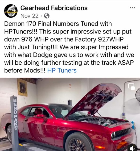

Results from the 1st dyno Tune.
