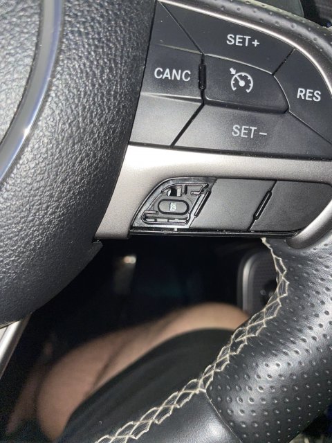

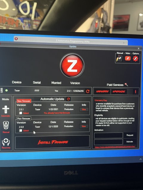

After installing the buttons, I cannot remap them. I also cannot remap any other button by holding the left arrow and then hitting the button. The car is in Run with engine off when attempting remap. So at first I thought it was the Tazer, did a full reboot, still cannot remap. Okay backed up, maybe the firmware has bugs. Went back one revision on 2.5.x and that still did not work. Then went back one revision to 2.4.x and that did not work. Unmarried the tazer, updated the firmware back to latest 2.5.x and then it still would not work.
Does anyone else have a 2015 Hellcat Challenger and has successfully remapped the buttons?

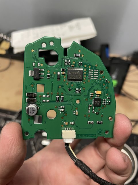

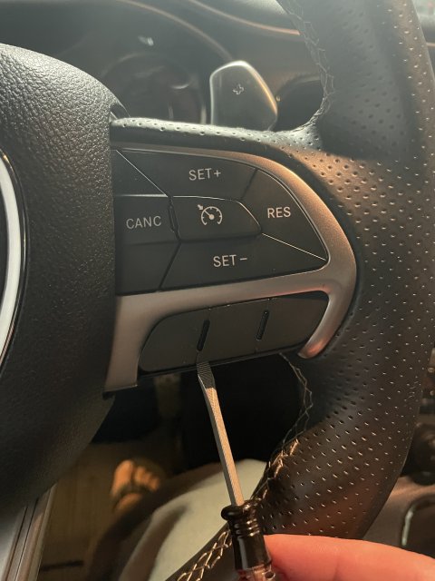

I feel dumb like Im the only person that can’t get this right. That or my steering wheel module is broken. Im going to take the wheel apart tonight and make sure everything is plugged in.

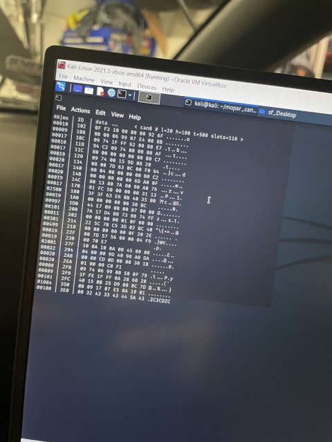

I did aome sleuthing, hooked up can bus analyzer to see if button presses generated any traffic. Nothing appeared outside of this already noisy bus.

Try removing the button and depressing the inner actual button and see if you get something on the bus.

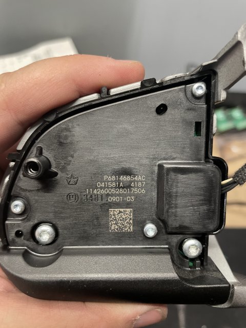

To clarify, I do recall something about a button change in the switch module between 15, 16 or 17
In the beginning, you had to change the switch module, then they came up with the button swap only method. But what's not clear to me is if this was a mechanical change or a parts sourcing change.
@fumanchu182

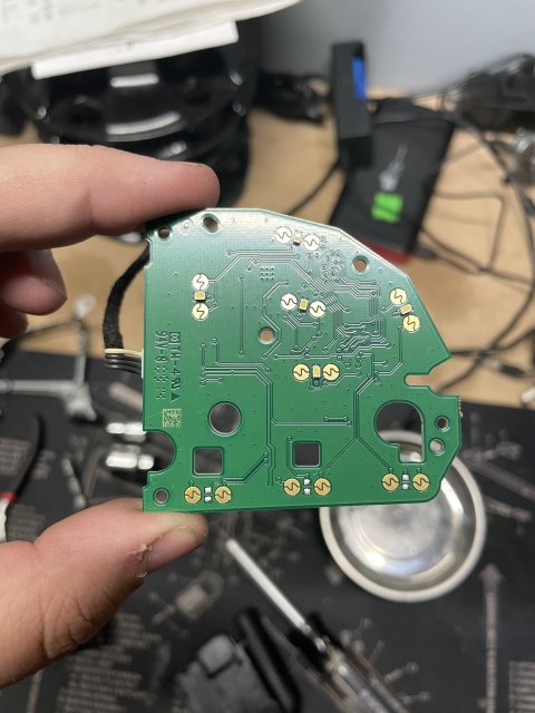

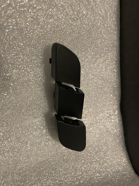

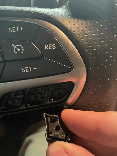

I might have to go this route. Took the cover off and hit the rubber directly, nada.

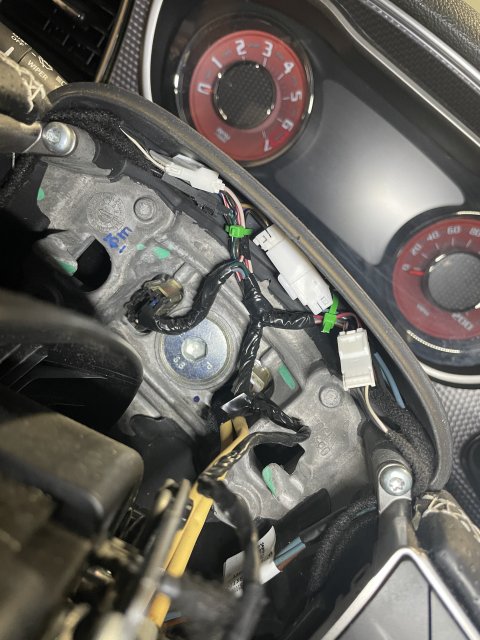

In decided to be adventurous and took the wheel apart.
Then from there I inspected the module when I got it out. Looks fully functional.
Tested continuity, tested ohms. Everything looks fine. Maybe this is one of those modules not programmed to work that way. Im willing to try another Tazer or button module. Ill try and see if my friends local will let me experiment with their Tazer. Ill try and ebay a 2016+ module.
