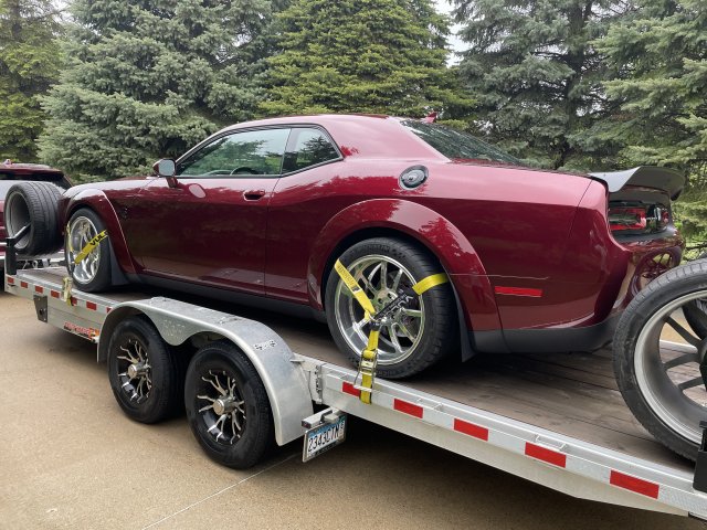

I X strap mine through the wheels since it's below the suspension. It stays tight 99% of the time, even through South Carolina on I95 north.

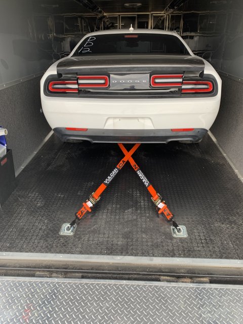

I cross them in the rear and the fronts i have straps that go through the front wheels, I use Vulcan straps and have been very happy with them. I currently do not have a picture showing the front, attached is the rear. View attachment 94531
Do the straps wear the finish off the wheels ?

The straps to wear the finish off the wheels ?
They don't. Never leave a mark.
The straps have a sleeve that protects the wheels from being scratched.

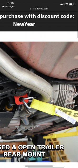

I cross them in the rear and the fronts i have straps that go through the front wheels, I use Vulcan straps and have been very happy with them. I currently do not have a picture showing the front, attached is the rear. View attachment 94531 https://zl1addons.com/collections/dodge-challenger-accessories/products/challenger-strap-points
What I am using for the rear points.
What are you hooking to on the car?
I use that red tie down piece from ZL1 Addons
29,414
130,603
I looked at them. Definitely easier but I don't trust any attachments above the suspension. It has a tendency to work loose?
