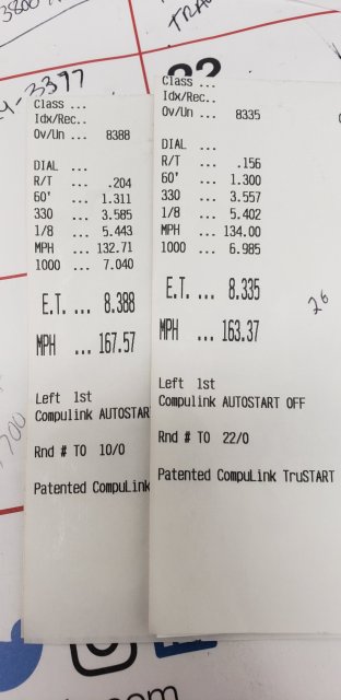

That 60'..WOW!

Super impressive!(y) Just curious if you will be running in a factory class?

It's good to see some time slips Marc. That thing is badass and looks like it'll sure enough be badass once it's lined out!

Nice!! Looking forward to your progress in the future. I’ve been watching the 60’ times on these and I guess my first question is.... how much are those 9” tires a limiting factor? I’m not really seeing 60’s like I expected at that weight. Obviously a 3000+ da is going to drag everything down including 60’s but even the proven FSS cars at the NHRA races have been low to mid 1.2’s. Any thoughts so far?

i had 14 degrees out in the hit ramping it in slow bradenton track is the best there is i did get a little loose in high gear on one run it was 95 degrees and did not push it to much i was doing suspention adjustments that did the car has more power than tire but that makes it fun.

Jeez! That's going to be crazy this fall in good air! Congratulations! That's one hell of a hotrod!

How much total do you run?

Awesome Marc. Glad to see it putting down low 8’s. With some tweaks and good air. Plus the other crazy shit you got in store, gonna be craaaazy

20 degrees total,i am running it rich rite now unti i get the v300 installed with 8 widebands then i will start leaning it out i am only running 14lbs of boost rite now

Good deal. The 6* on launch and rich explains why it looks lazy those first 10-15 ft. It has a ton left in it from the looks of the vids.
I see that the rear leaves "flat", no separation. Does it have a typical 4 link under it that can be adjusted?
Lastly, will the car easily hold more tire, or is it designed just around the small tire?

it has a 4 link but to the fss rules,the bottom bars are not adjustable top bars are and you can put preload in it it has about 120% anti squat in it now the rebound is as loose as i can make it i am going to need a differant shock,the instant center is way above cg so as designed it will never lift the wheels much i am going to make a bravket to bolt in so i can adjust the lower when not racing fss,the car sits very low and not much more tire will fit,i want to try a 275 radial and see how that does,the car does have good bight but then releases about 60 ft out i think with less rebound i can carry the front out further and try more power off the line.
