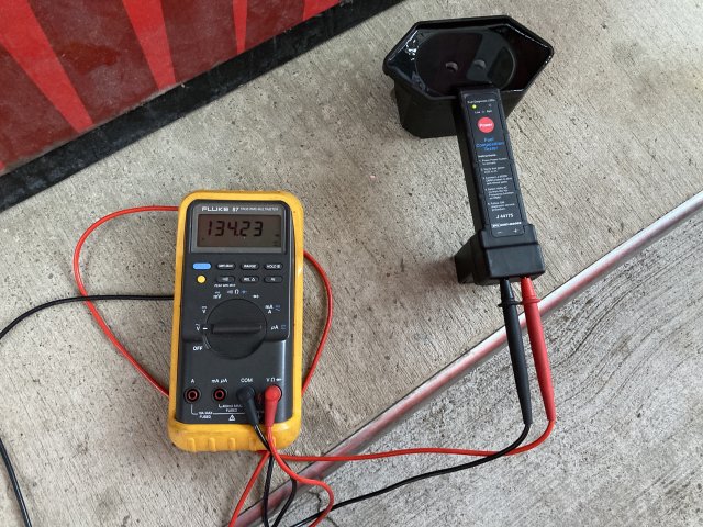

Get a tester like this, instant results from only an ounce of fuel. Accurate to .5 % With today’s additives in ethanol to combat its hydroscopic tendencies the baby bottle % test does not give quick accurate results, it takes hours for the separation to occur now. You can read articles on this even on Injector Dynamics web page. This unit display minus 50 equals ethanol %. Only part I don’t like about it is having to use a separate multimeter for the reading but I plan on installing a battery operated small panel meter in the units hard case which will take care of this issue. This is E85, I’ve seen it test as high as E87

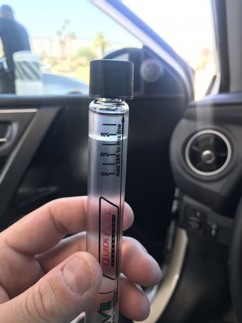

That is awesome. Looks easier than doing this whenever I fill up. 👍 8CA4AE2F-1E4C-4500-805A-FD36A348C735.jpeg

Read up on the accuracy of testing today’s ethanol verse years ago before all the additives where added that keep water from separating out of the ethanol to which they drastically slow down the separation process the add water to the fuel and shake wait for the separation to occur method (water bottle testing) rely on. I read enough that convinced me to use a tester that works differently. I agree it’s cumbersome, it will all just be in the units hard case soon. Open lid, put oz of fuel in, subtract 50 and instant very accurate do I put it in my tank or not results.
3,662
8,605
I do like the little bottle though, it may be worth comparing to this testers result and hell maybe go back on the bottle lol

This Injector Dynamics Article and talking to them on the phone about fuel testing steered me away from the bottle method. ID advertises itself as a no BS company and makes some of the best injectors out there so I took their advice pretty highly.
http://injectordynamics.com/articles/e85/
