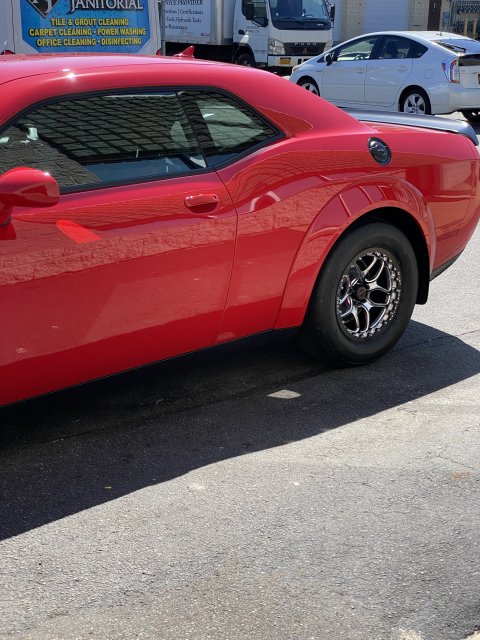

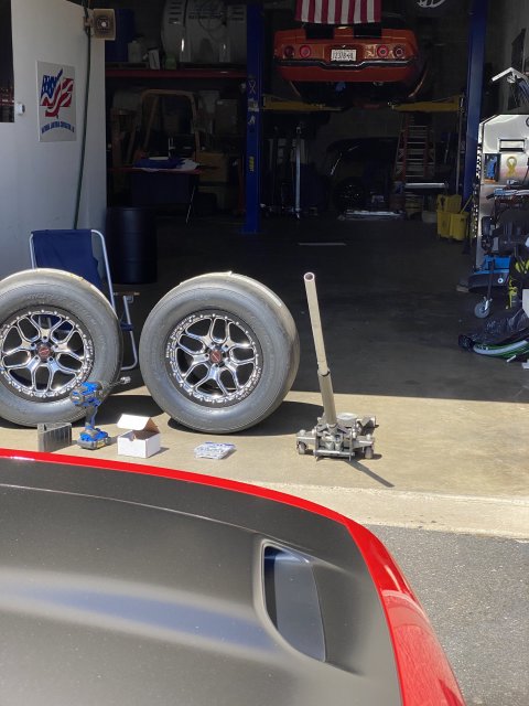

Guys, drag pack rear tires rubbing slightly “inside front” portion of the plastic wheel wells, just enough where it’s down to metal..have track event 4/20. Thinking a spacer? Suggestions on good product please. TIA

I bet you have the wrong rims. With 5.25 back space you should not be close to anything even with a 315/50R17. Looking at that pic it looks like you have the wrong rims.

They sent you a Drag Pack rear wheel. Those are only made for the Narrow Body. Drag Packs were never built on a Wide Body.
If your invoice says "Dodge Wide Body Single Bead Lock Rear Wheel", then they definately sent you the wrong wheels.
