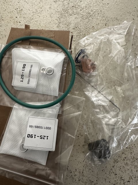

No. I’ll confirm it’s the right part when it comes in this week
This shows at a few sites as for a charger hellcat but not a challenger yet the tank is the same so IDK.
Definitely share once you know.

Thread Starter #82
Update: it looks like it’s the correct arm. It’s only for 15-16, which is strange - I wonder if they changed the jet pump after that. Will release part number once I have a chance to pull jet pump and confirm. Was manufactured in the US in 2021 a also strange, being that it’s discontinued - was expecting it to be NOS

Thread Starter #85
Finally wrestled some pythons and did the passenger side jet pump fuel level sensor. That 100% was the problem. No splicing needed, I disassembled to connector, depinned it, and put the new one in. All fixed up and hopefully won’t have to play with the fuel system for a long long time. FYI, that white clip on the hose that goes to the driver side was white. It turned orange in 2-3 months. I see it losing its tension again eventually.
