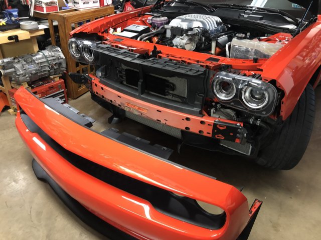

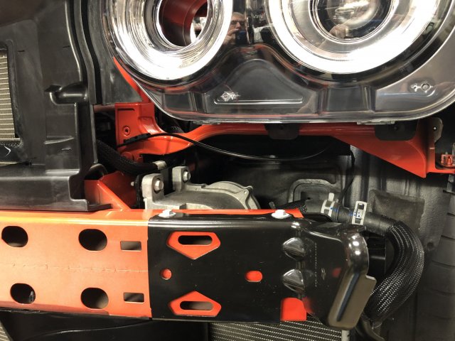

Easiest way is take the front cover off, you end up taking bunch less apart doing it that way. Cover only takes about 45 minutes to remove and then the pump is right there 4 bolts and it’s out.
