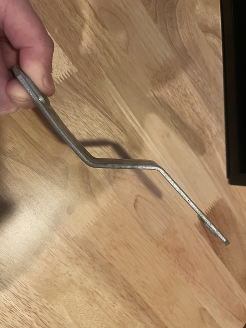

I used this
As a pry tool.
Popped right up

Does it engage with the seat brackets in the same way the seat does?
Push back, pull up? Easy with the right move, 'won't come up without that backwards push first.

Tired backwards push and pulling, still nothing. Used a trim removal tool. Lifted it up high was I could be hand until I could locate the plastic clip. Lifted up on the side of the plastic brackets
