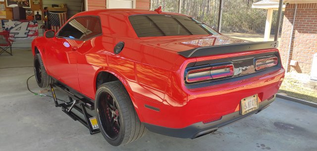

So, finally installed my brace (older version) and have a question:
I could not install the rubber spacer (absolutely no room / spacing for it).
Is it ok to have the brace installed metal to metal?
Would using the Quick Jack (meaning no weight on rear end during install) cause there to be an issue with not being able to use the spacer?

Used a quick jack

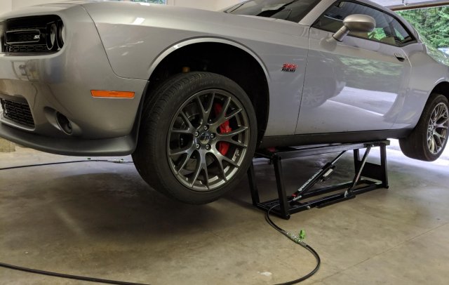

maybe I`m confused :unsure:,what is a quick jack. I`m spoiled only used car lifts an floor jacks my whole life.

had to google quick jack, now I know :) seen them before never used one before. looks like a sore back jack to me.

Used a Quick Jack.
No weight on differential.

Can you post pics? I'm not sure how it would fit without it
It might be due to the Quick Jack use.
Absolutely no room for the spacer.
Will try backing onto ramps, loosening the 2 frame bolts and see if I get any spacing.
