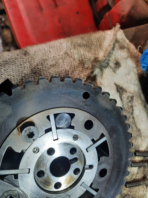

I have the same cam waiting to be used, just installed the vvt block the other day
Ill do that when I get some free time. Otherwise Ill lose it haha.

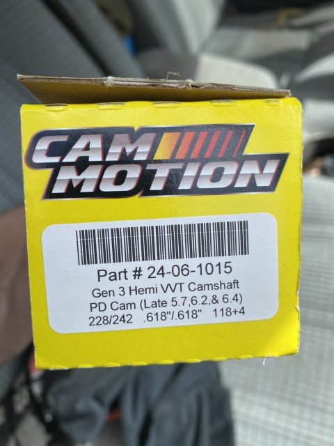

We use both TSP and Cammotion for our cams. I talked with cammotion about my setup, and this is what they recommended. I sort of wished he would have changed it up a little so we could call it our own, but I've been dealing with them for almost 20 years. I trust them, so here we are.
Keep us updated how you like it. I'm hoping it has a little sound, but not too crazy. Want to stay a little incognitoish
@Hpindy has the same cam an you notice a difference from stock but not much.

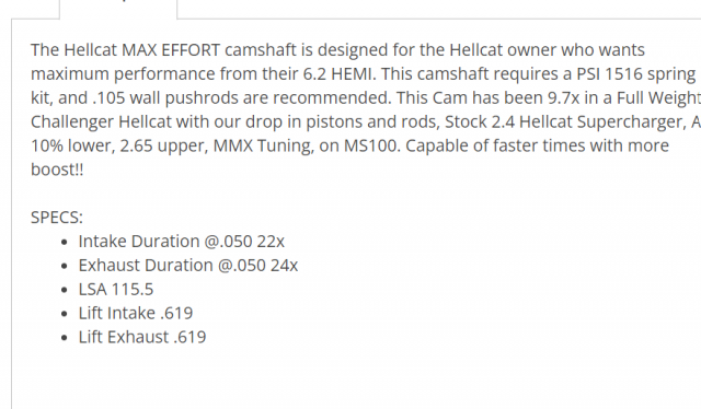

This is a fantastic camshaft for a boosted engine.. -1 overlap so you are not blowing boost out the tail pipe and the opening and closing events are very very good ..

What you guys didn't want this cam that says with a 2.65 upper and a lower you can get a 9.7 1/4 mile :ROFLMAO::ROFLMAO:
I think that would slow you down with those mods.
Ouch ....
